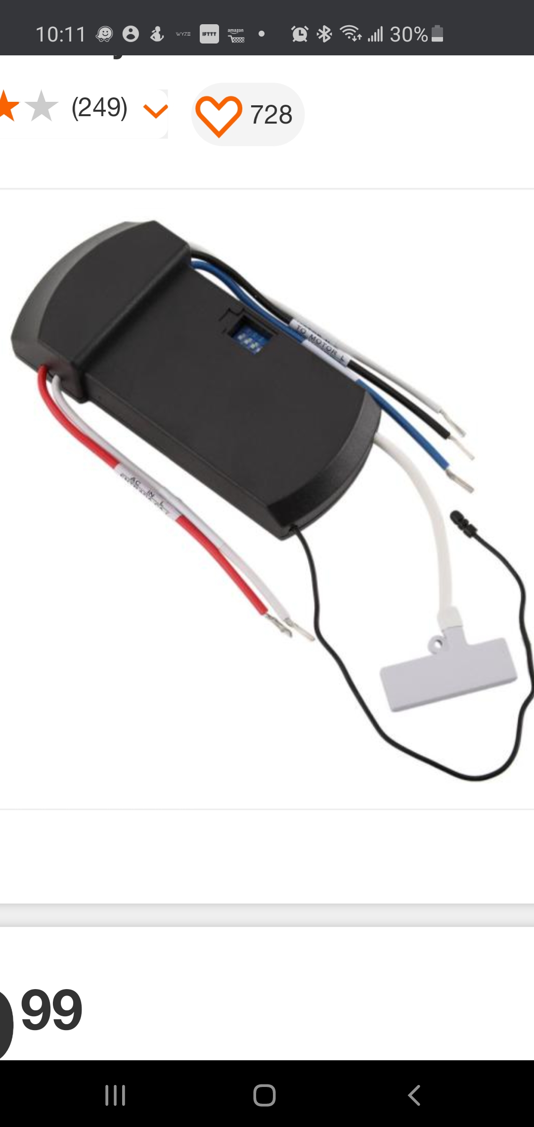

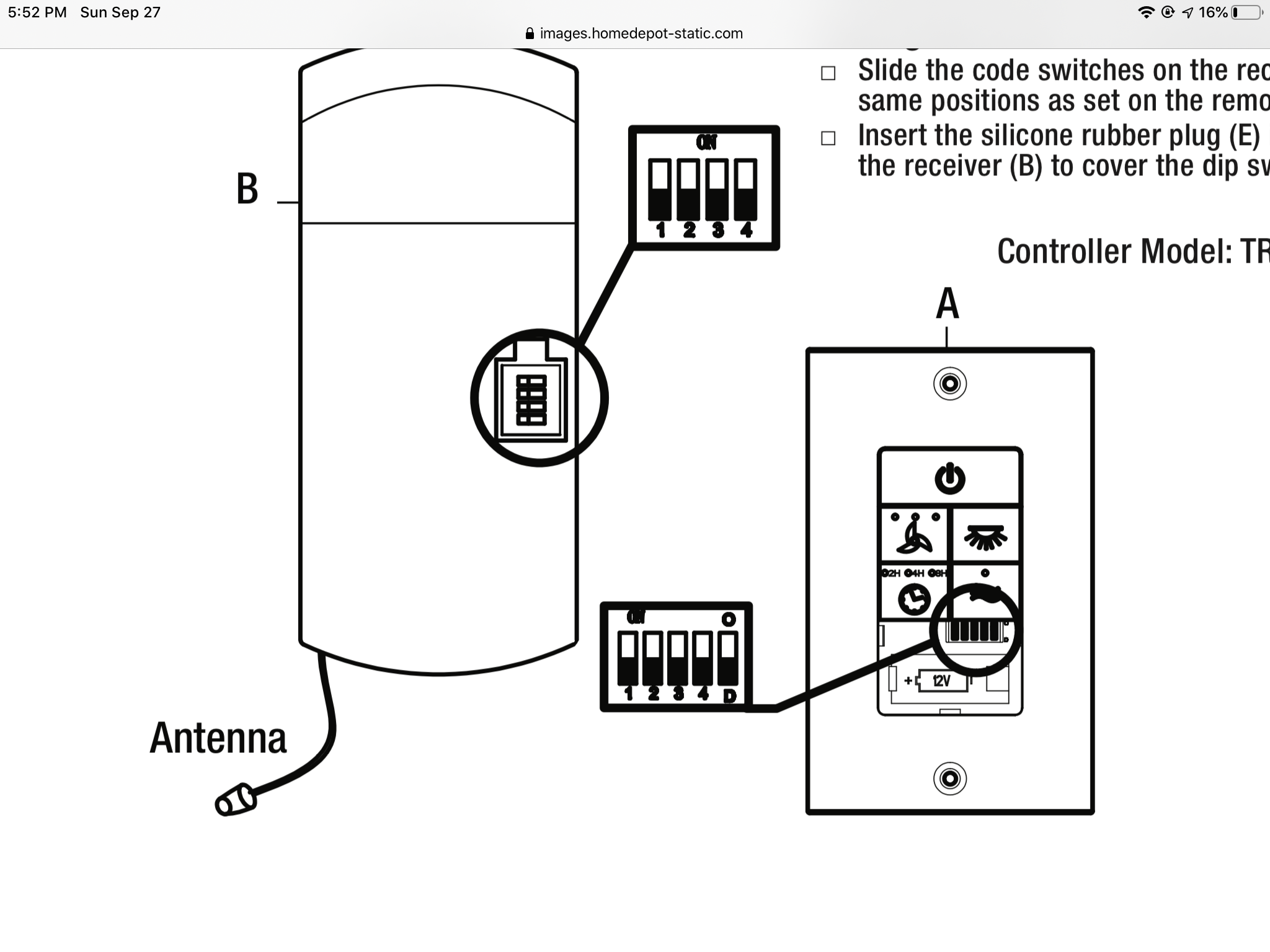

Home depot brand Hampton Bay is one solution that might work for you. It has standard controller that also has zigbee radio. It comes with RF wireless remote. If you want wall mounted remote (switch style), there is solution for that leaves you with extra non zigbee controller. That wall mounted RF controller can be paired to zigbee controller.
Zigbee package currently $50:
