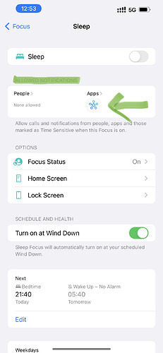

I think I found the solution. At least it works again as of a few days ago after these settings.
Please see the attached pictures.
Basically, all you have to do is go into Settings->Focus->Do not Disturb and under ALLOWED NOTIFICATION (for apps) add the Smarthings app.
Repeat this also for the Sleep menu.
Settings->Focus->Sleep and under ALLOWED NOTIFICATION (for apps) add the Smarthings app.
iPhone 13 Pro Max ios 15.2.1
Worth a try.
It may be a coincidence: without trying this, I’ve noticed that location tracking seems to have improved over the last 72 hours. My wife’s phone has properly registered location presence by both SmartThings and Webcore 3 days in a row!
Didn’t work for me…but thanks for trying!
