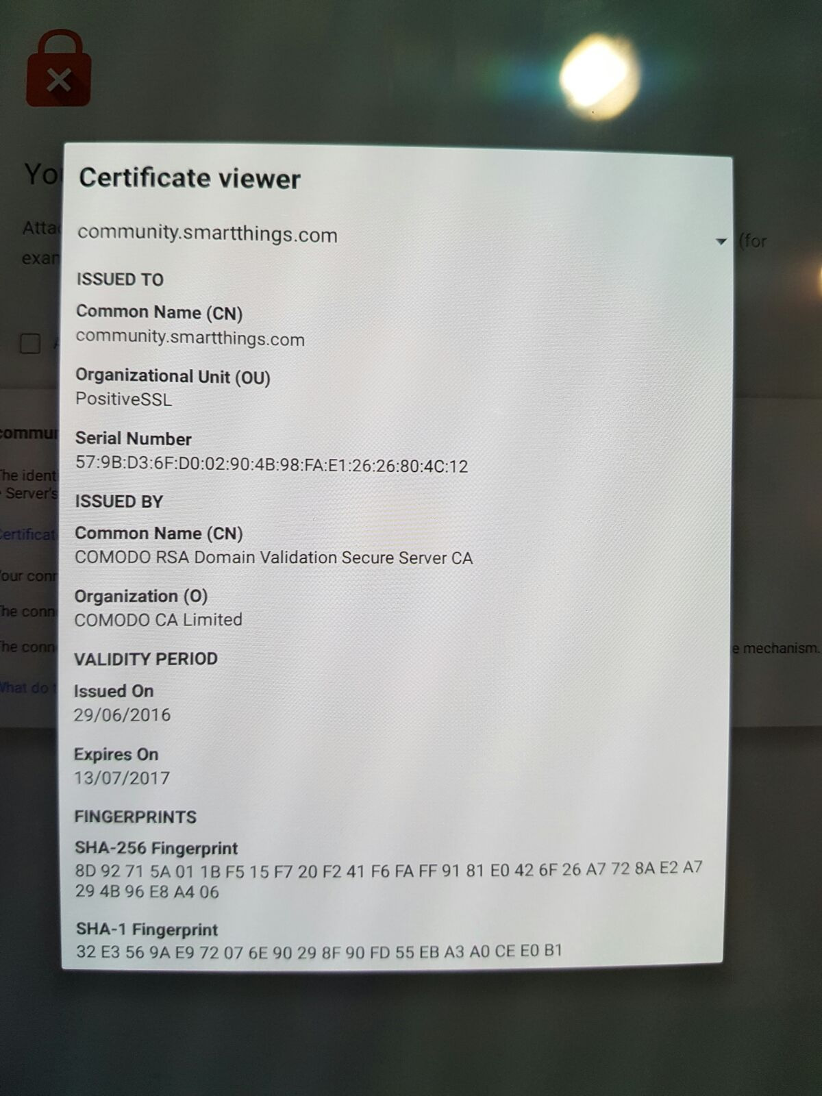

I’m on Android 5.0.1 on a Tab S and Chrome on the latest stable version… and I have those errors… but not on Windows nor MacOS…
Can someone actually post a screen shot of the full error they are getting please.

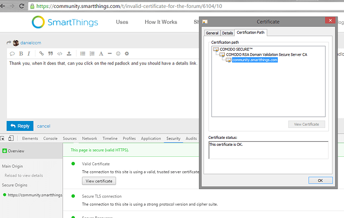

Thank you, when it does that, can you click on the red padlock and you should have a details link, click on that then click on ā€˜View certificate’ and finally go to the ā€˜Certification Path’ tab.
Can you grab a screen shot of that please.
This you mean?
Looking more for the full chain to see where it’s breaking down but just noticed that Chrome on Android, lemmie just check how to do it on Android.

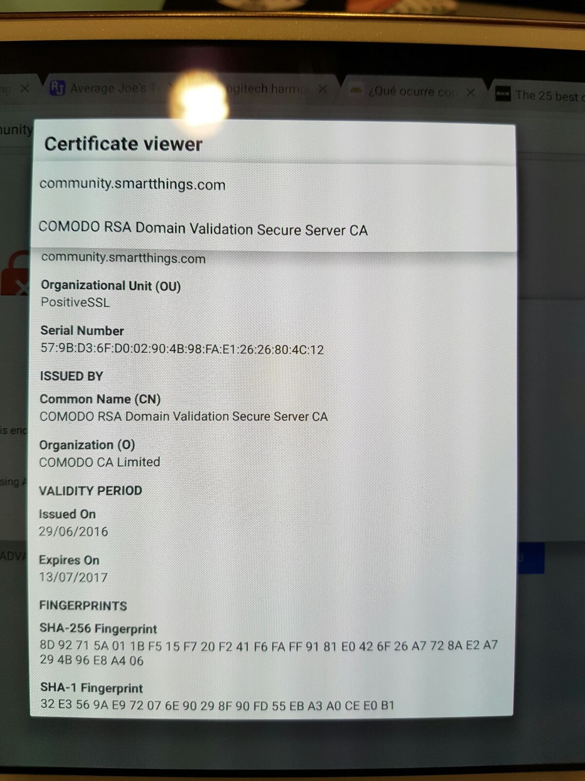

Okay, kinda the same, see the drop down arrow near the top next to ā€˜community.smartthings.com’ on that same ā€˜Certificate Viewer’ page, click that and take a screen shot.
Thanks for your help.
No prob! I may not be a programmer, but I do try to act as a good guinea pig… lol!
Okay, so it looks like it’s breaking down between the intermediate cert and the root cert, if you tap on the "COMODO RSA Domain Validation Secure Server CA’, what does that page look like?
Okay, that seems to match the serial / fingerprint of the intermediate certificate I’ve got so either the root certificate is not being sent with the rest of the chain or it’s corrupted somehow.
Given that people are only experiencing this on certain browsers/systems, what’s weird is that it works fine on my Android 6 phone with Chrome. I’m guessing the site isn’t supplying the root certificate and some devices don’t already have it in their Trusted Certificates store on their device.
