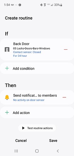

Apparently I spoke too soon!
The last couple of days I’ve been experimenting with this & having no luck. As you correctly point out, you’re not comparing temperature with a threshold. I tried a comparison with a range of temperatures and found once the sensor reported I could set a virtual switch from the initial event. However all subsequent events, still within the same range, do not cause the event to reoccur.
Obviously, motion is required for that type sensor–which fails if you’re not home or never enter a room with the sensor during the time period.
So, nothing jumps out as workable to me using the stock Routine capability of the SmartThings app. Perhaps the Rules API could do this, but I haven’t spent any time in that area…
ST Routines don’t support the notion of “any change”, but rather state changes from one state to another. So, a range of temperatures will not produce a state change if it is still within the range.
You could use a 3rd party rules engine like Sharptools which has the option for “any change”. The tradeoff is that the routine will run in their cloud, not local on your hub.
