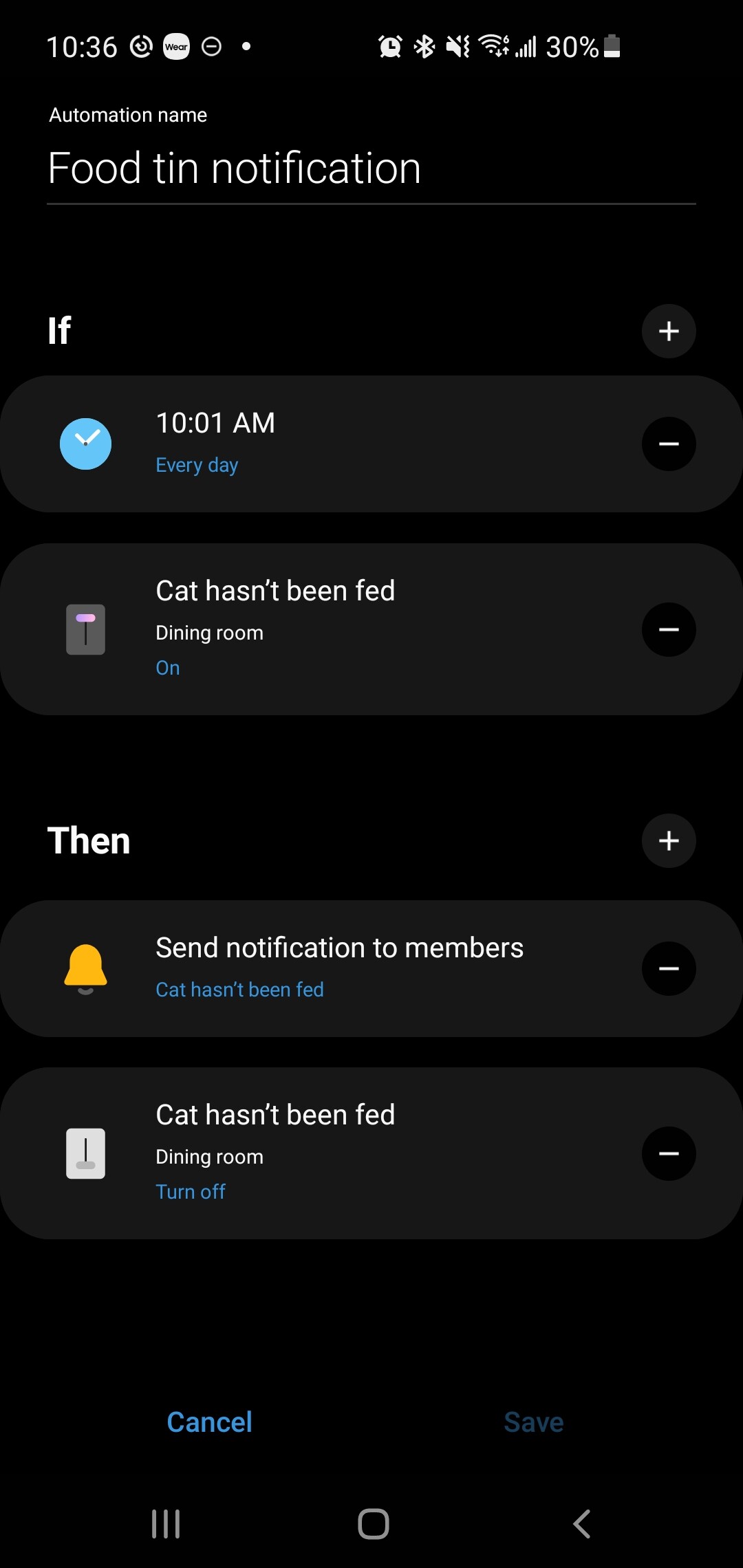

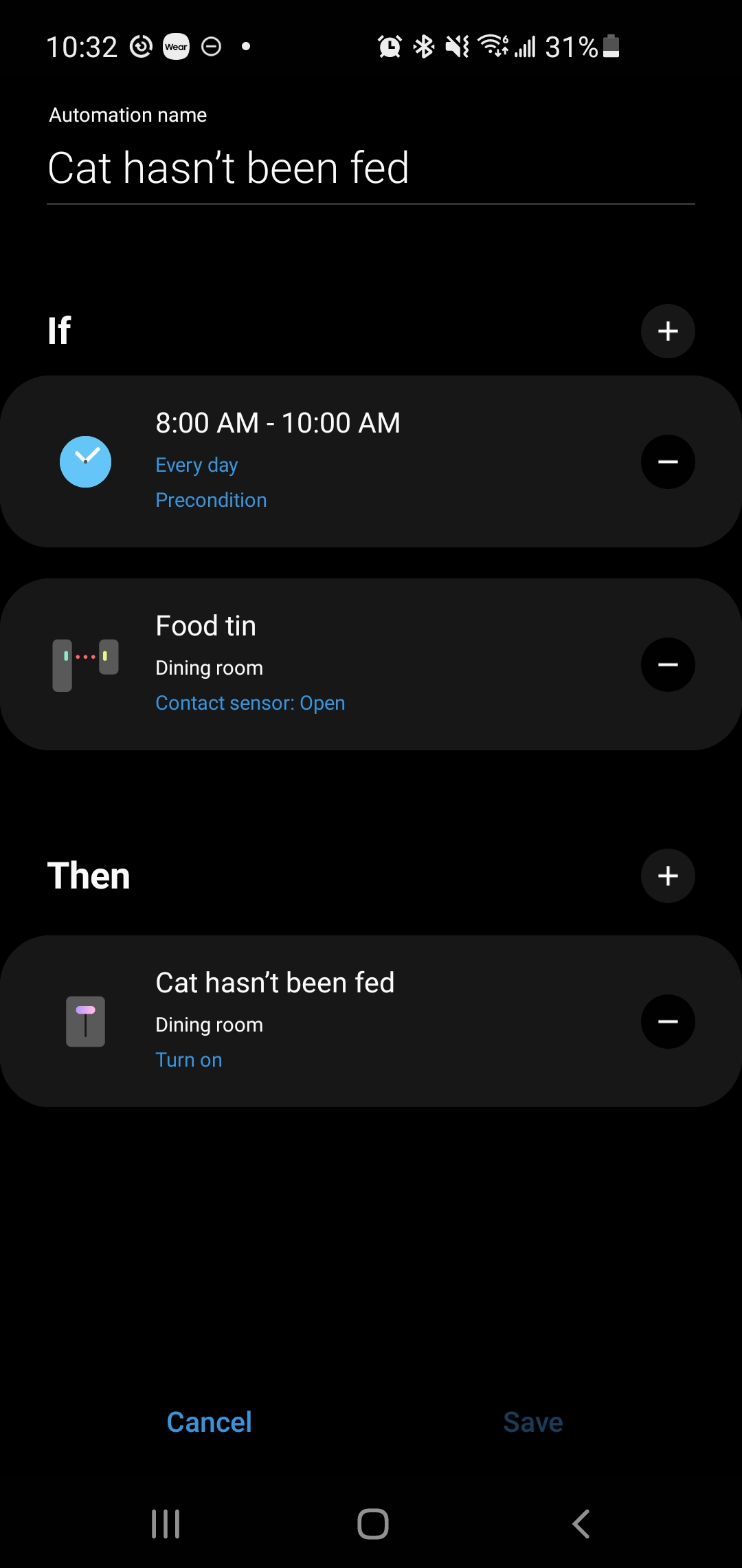

You can do this with automations. Times are just an examples.
  1. Create virtual switch for example ”cat hasn’t been fed"
  2. Create morning Automation that if food tin is open between 8am and 10am, every day, will turn virtual switch “on”.
  3. Create automation that if virtual switch is off at 10:01am send notification "cat hasn’t been fed”.
Do same for second time period.
I have made couple changes to simplify automation and reset virtual switch, but this will do it
