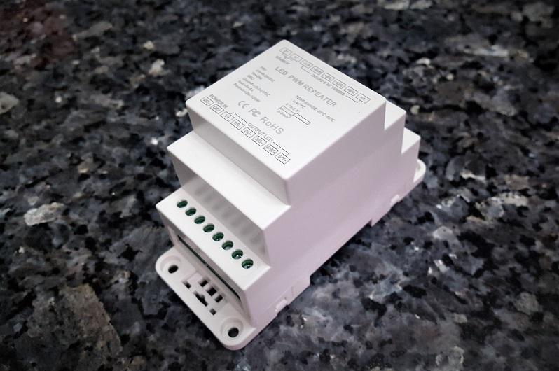

I believe the controller is current limited so the more LEDs you add the less current there is to go around and therefore brightness per LED will decrease. I am moving away from Hue so I stopped all efforts to get more light out of my led strip setup but I recall seeing an amplifier that was supposedly compatible with Hue (something about very fast PWM frequency). I believe this might be it but you need to check whether it will work with HUE as well:
