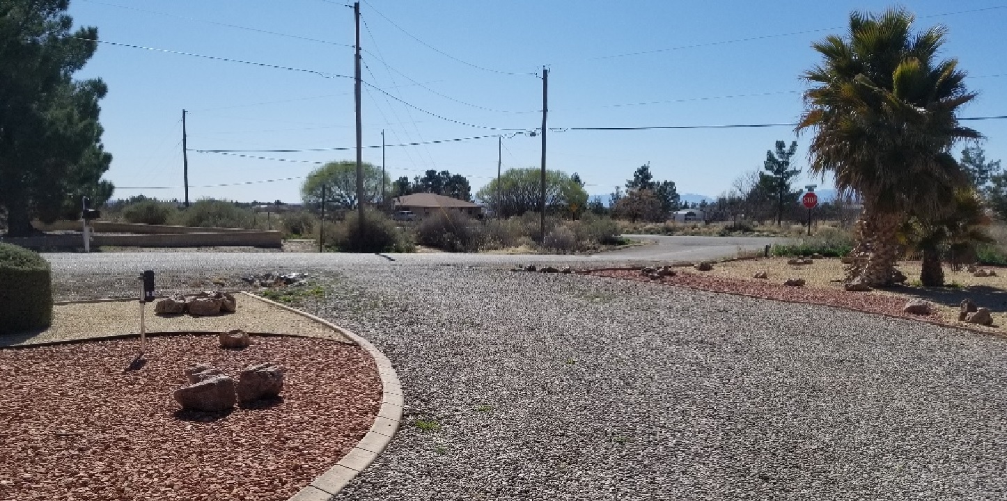

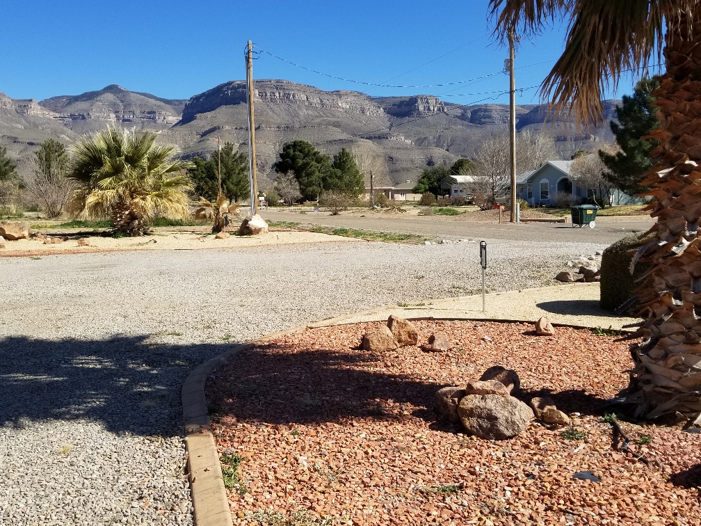

This gives you an idea of how the sensors look, and the distance I placed between them

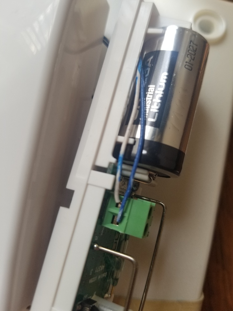

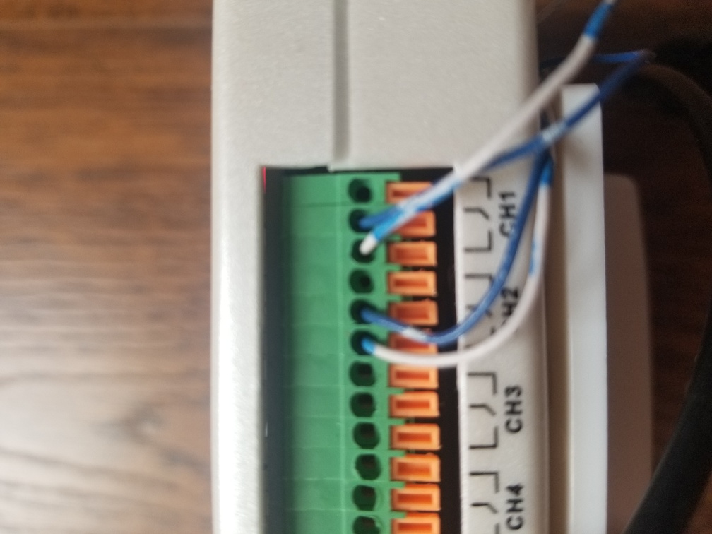

Hey dan, I have the same issue, I got the same products as you, but I was wondering if you could give a couple of closeup pictures on the wiring on the alarm unit. Especially inside the ecolink sensor. I see 3 connections for each zone on the HTZSAFE alarm unit, which ones did you connect? Also what gage of wire did you use?
Thanks in advance,
Jeff
Jeff, Looking at the alarm unit, I wired to the two spots on the left, out of the three. This gives me “normally closed” when I look at the sensor in my Smartthings app. I used 22 gage phone wire.
I also opened up the back of the alarm unit, and there are four rows of connections, each with a jumper you can pull off and move. On the far left row, I moved the jumper to “10 seconds” . This is the time it takes the alarm unit to reset the dry connections before it can be re-triggered again. I don’;t remember what it was on originally, I just thought 10 seconds would be a good choice. I think there is a 1 second also. But this works for me. i really like this system. Still no false alarms, and it’s got everything coming in the driveway.
