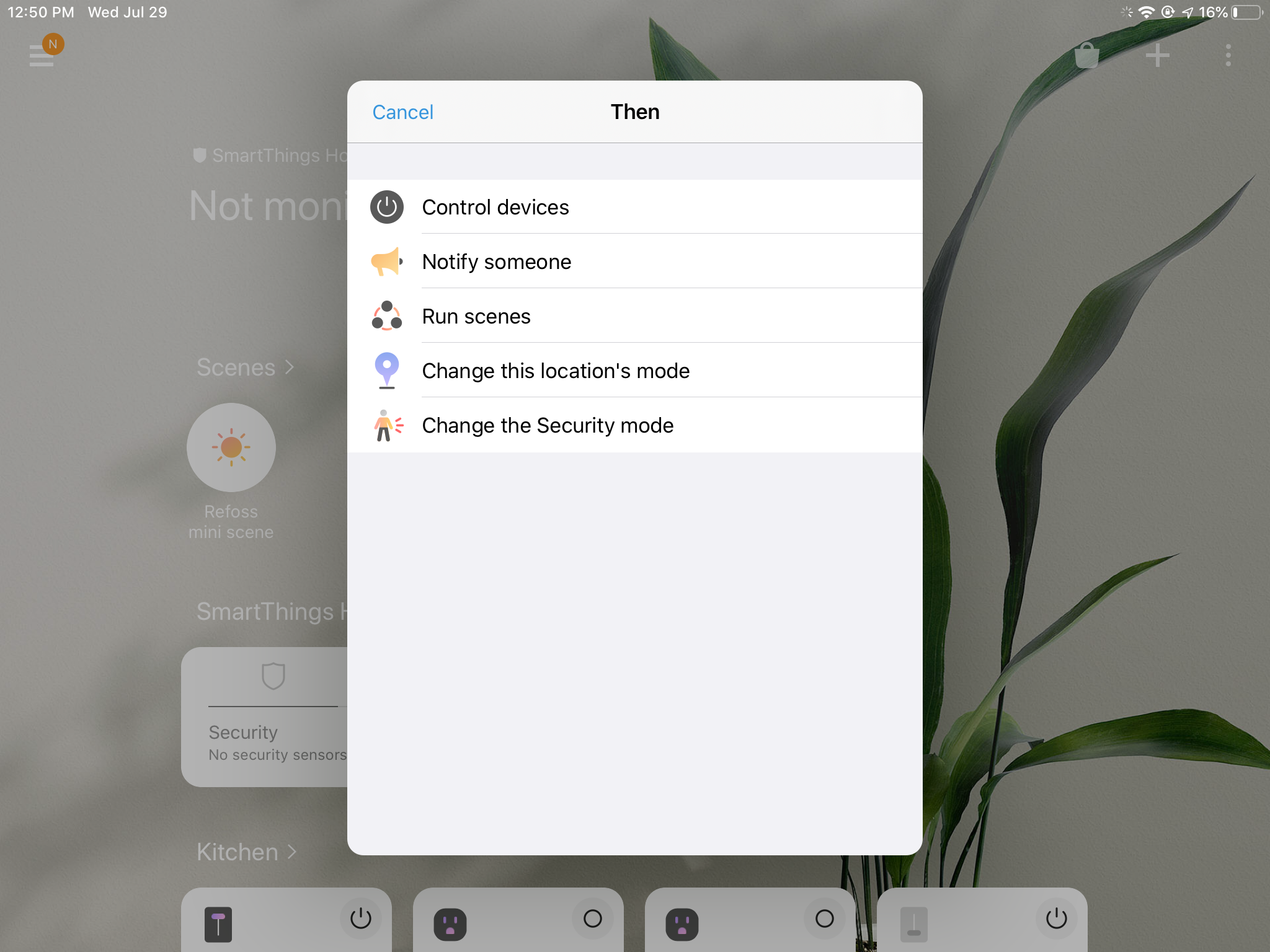

But more typically, you activate a scene by including it in an automation, rather than the other way around. So usually you would get to the point in an automation where you can select either devices and/or scenes to be controlled.

Think of automations as a “state of being” especially for unpredictable moments… when it rains, when motion stops, when sunset happens… low battery… and multiple things and/or… then you can ask the system to “watch” for these states and whenever it happens, however often, run a list of your things. That list can be grouped as a Scene. Scenes are like button triggers… group around a widget or a real button… press and go. When to press? Run it from the automation. So I’d suggest make a scene or two grouping the lights you want on and off at a button press then add those as the action to your automations
