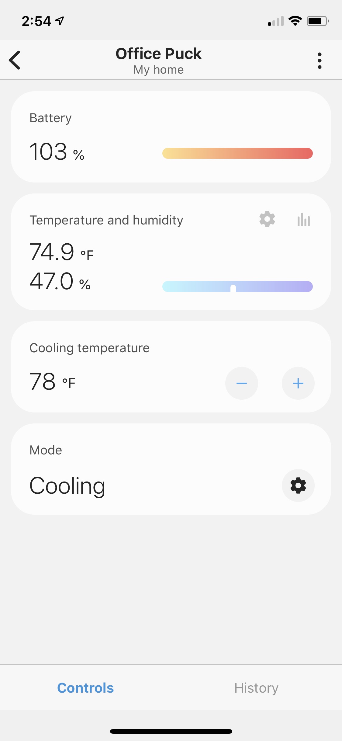

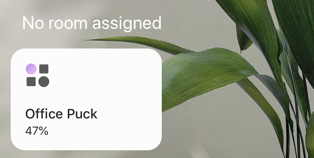

I have read through a lot of documentation and I have not been able to find how you pick what is displayed in the “Main” view of the new app. I created a DHT to be able to read data from a Flair puck through the use of their API. I am able to get get all the information I like from the API and it displays correctly when in the details view. I am not picky of the order of how the capabilities tiles are displayed in the “details view” (once you click on the device), and I don’t need any custom attributes or custom capabilities, but I would like to be able to show a specific value while all devices are shown in the “Main” view. In this case, the temperature value. For some reason (randomly?) value displayed is the RH instead. I am thinking there is something very fundamental I am missing. I’ve read enough to understand I can’t use the “Tiles”, “main” and “detail” commands anymore (I think…). Can someone please point me in the right direction?
Here are some pics:
You can see that the main display is showing 47% instead of 74.9 dF
Thanks in advance,
Jose
