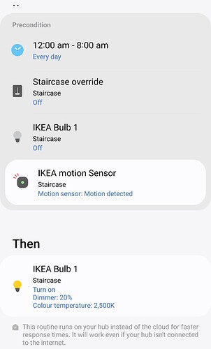

Hey @h0ckeysk8er! Sorry to bother you again. I was wondering if you have any solution for my current issue: I have the motion sensor routine based on a specific timeframe which should turn the lights on + set it to a specific brightness. The bulb does turn on but the brightness does not change according to the implementation. I have 2 of these routines. The only difference is the light brightness for different time slots
Couple of things to look at here. First, some switches have a setting for what dimmer level is set when the device is turned on. My GE/Enbrighten motion dimmers have the notion of a “default dim level” which is what is set when the device is turned on and then can be adjusted by the Routine.
Another thing to try is simply removing the “Turn on” action and just set the dim level. Since the implementation of Edge, simply setting the dimmer level will both turn on the device and set the dim level. You remove the “Turn on” action by clicking on it and the radio button should be “unhighlighted”.
