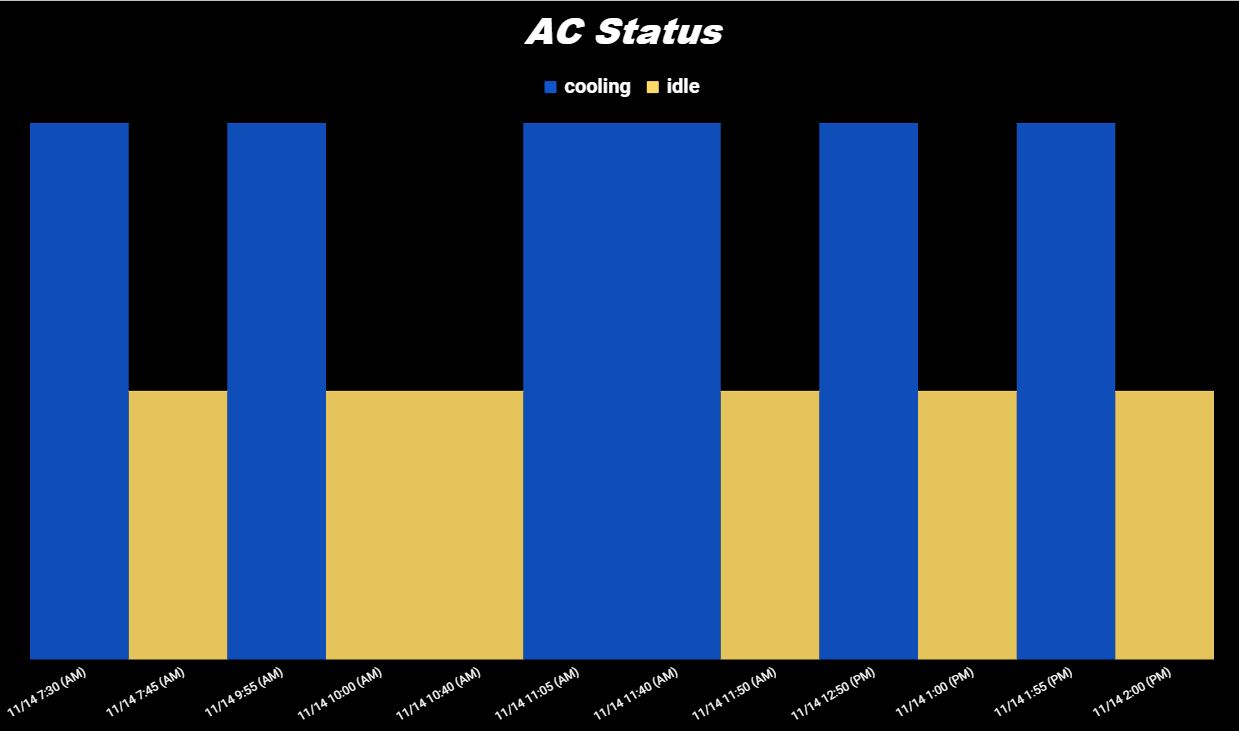

You should end up with a chart that has bars sticking up for when it was either cooling or heating and a level bar that shows when it was idle.
- In the next tab for the chart editor window you can now customize the chart to your liking in terms of color, background, grid, giving it a title, hiding the numbers, etc.

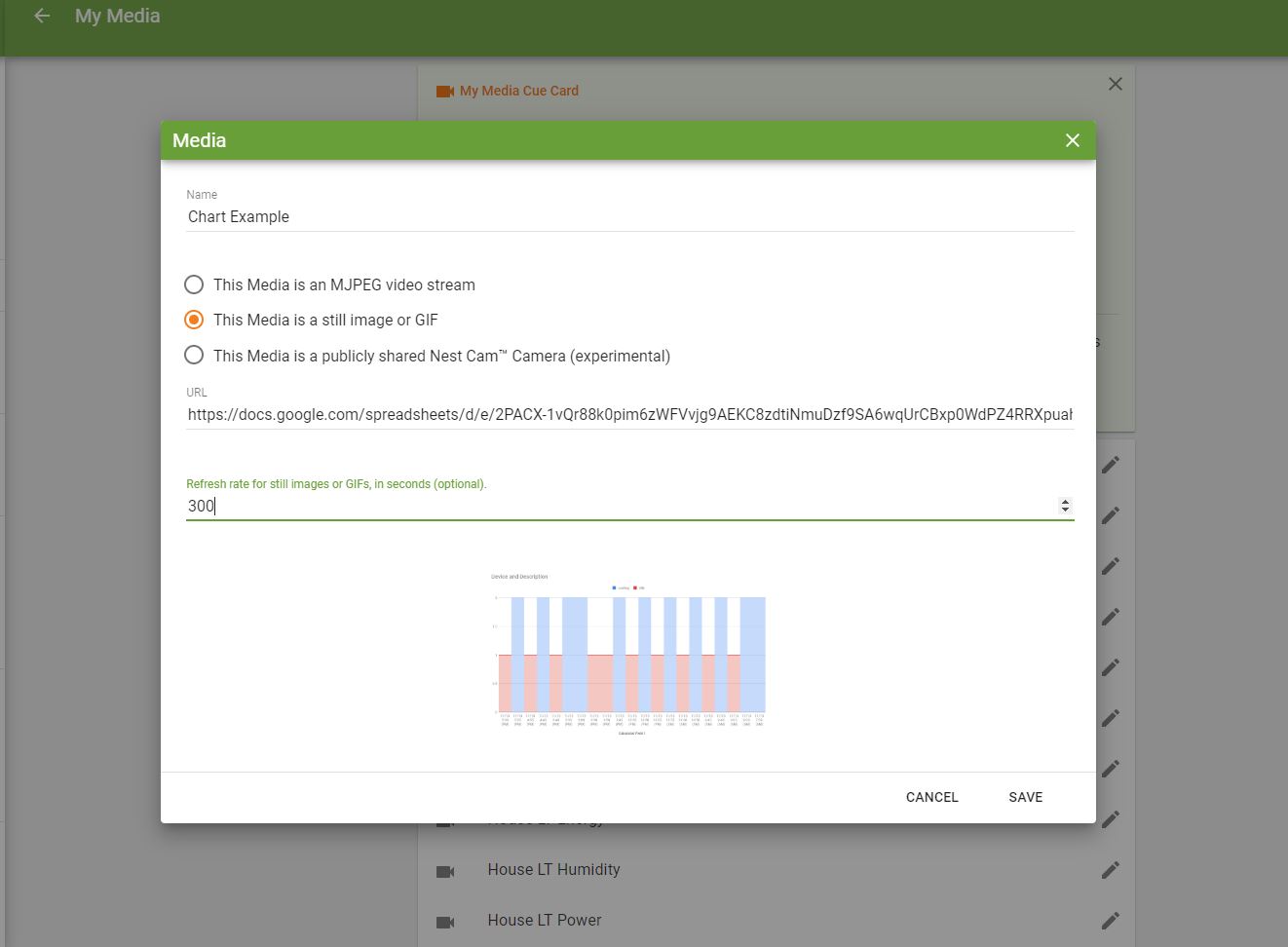

Log into your actiontiles
On the lefthand side click on “My media”
Bottom right, click the orange “+” ball
In the window that pops up, name it whatever you want to call this chart view.
Below the name, select the second option of “This media is a still image or GIF”
In the URL window paste the link you copied from the sheets publish to web window. At this point if everything worked fine it should give you the preview in the bottom of this window and you should already see your chart.
For me I then add a refresh rate to not bog servers and such down with constant push value. I have found that even just a every 5 minute (300 second) interval is enough to give me current enough data at a glance. Whether you do that or not, hit save to finish.

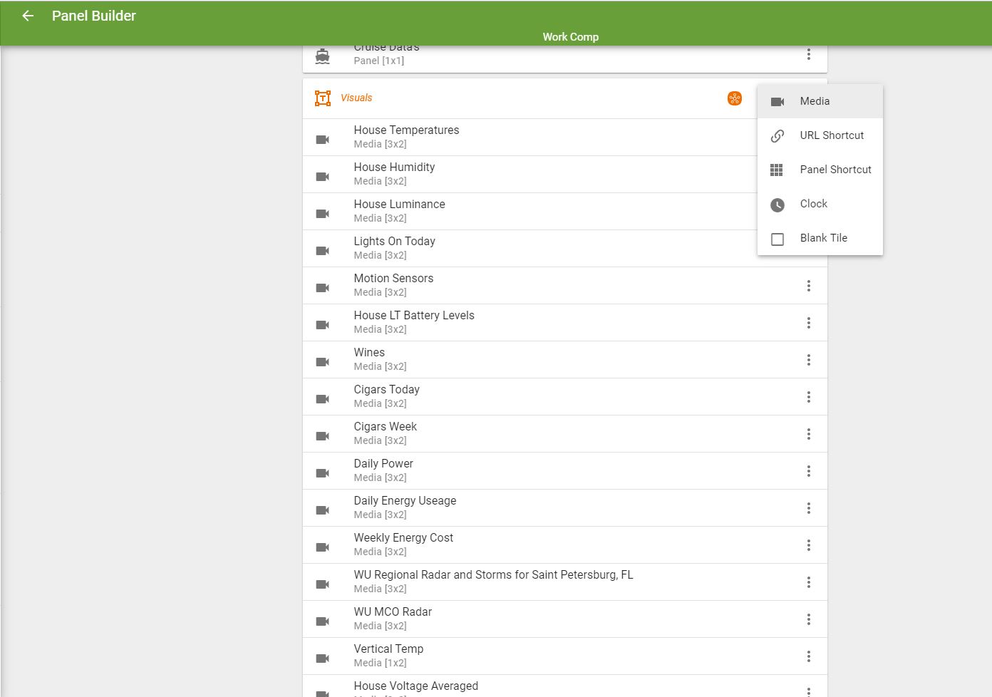

From there using the left hand navigation window, go to “My Panels”
Select edit (click on the pencil) of the panel you want to add the chart to
If you already have a tile set built you want to put it in just click on the orange “+” block in the tile set you wish to place this chart in and click on the media option
From there choose the name of the media you gave your chart and click add.
Go back and actually view the panel you have added it to and it should be there!
And lastly here is what mine looks like once all done!
