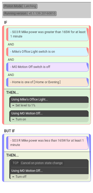

This is where smart outlets come in handy, I keep all my activities centered around motion, but when I know motion will be low, watching tv, playing games, etc, I make sure the CoRE Pistons evaluate power as well, it’s amazing how accurate this can be. My office piston knows when I’m working on my desktop, playing games, watching video’s, or working at my workbench, all based on power usage profiles. My light and fan do different things depending on motion and those power readings. Works very well, but took a long time to get just right.
If you’re willing to share I’d like to see your pistons on this to give me an idea of where to start.
This is the primary piston and one activity piston, I then have some that reads power levels and if different than this piston, it sets lights/fan as needed, I think four pistons are tied together for all of this. Temp readings are taken for the fans as well. These are the base level readings, others build on it as usage increases (ie second piston,) that way dimmer levels for example will revert to previous levels automatically without doing state saves or variables.
