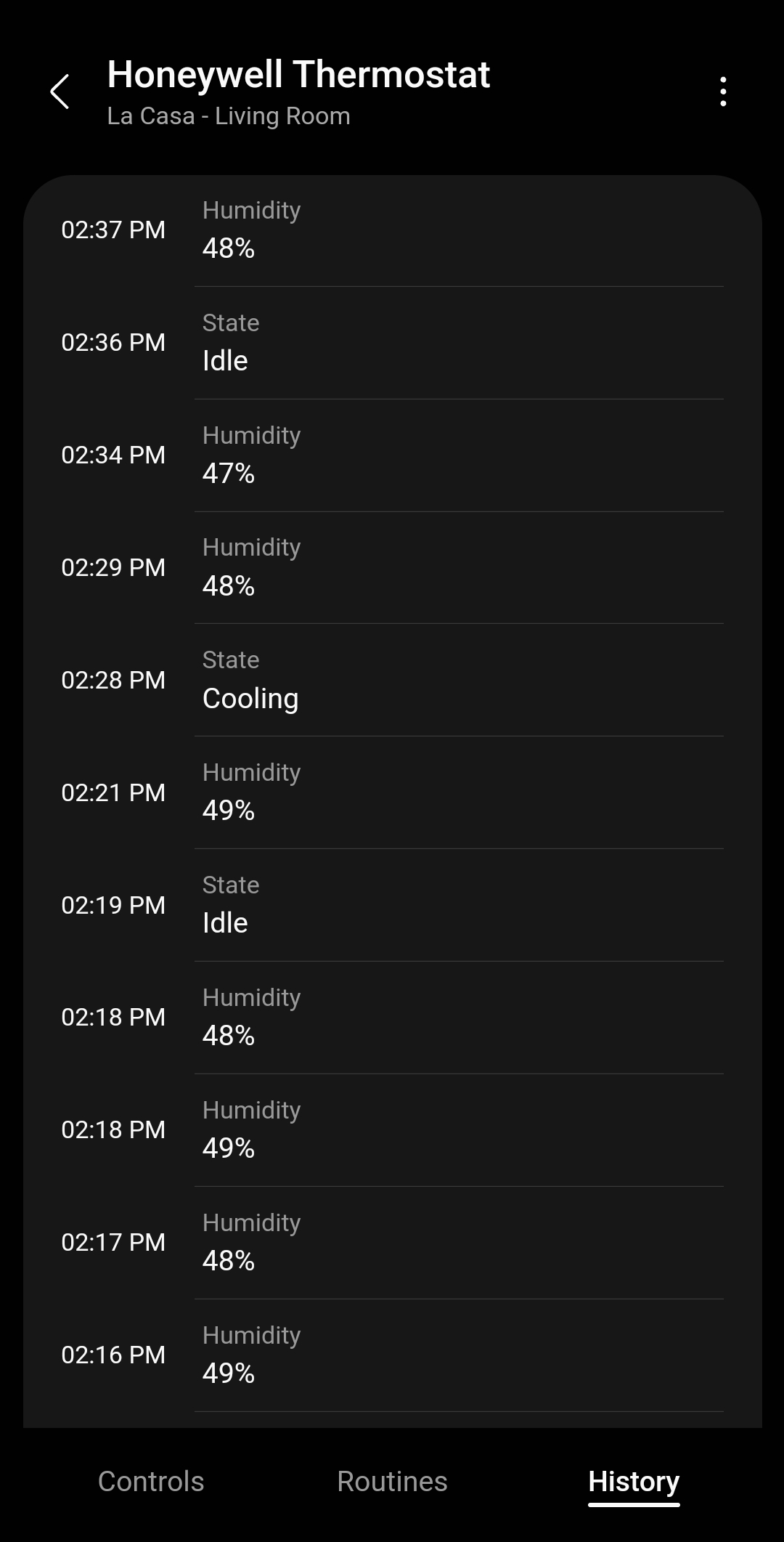

just got this zwave thermostat up and running. all seems to be working except a little confused of its built in Home/Away feature. it didnt go into Away Mode automatically. Thermostat has a native Away temp setting for heat and cool. i had to set up a routine for it to apply a higher cooling temperature when Location Mode is set to Away.
