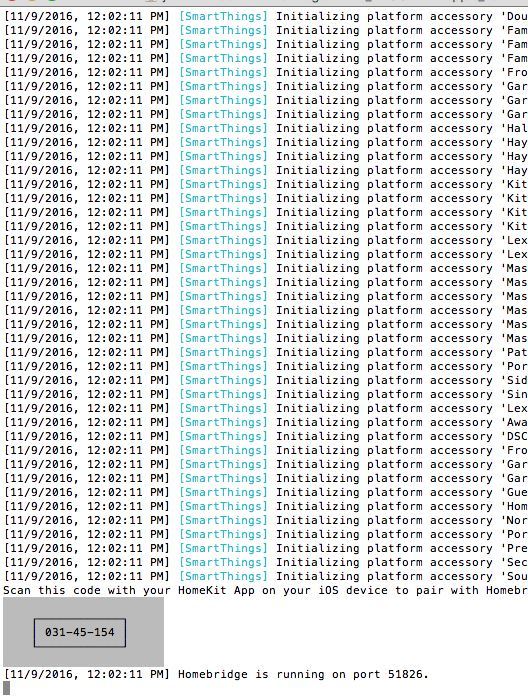

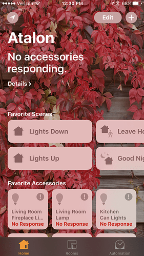

@Kamran As of last night, Homebridge and SmartThings are not communicating.
Homebridge is still running on my Mac Mini. The app id and access token haven’t changed in the smartapp.
I restarted the Mac Mini and homebridge.
Each device in the Home app shows “No Response” and the scenes “Failed”.
I haven’t changed anything! Did SmartThings changed something?

Wonderful for you. Any suggestions to re-establish connection with HomeKit?
Is the json API working fine?
I believe so…
What is your devices app showing? Did you recently add anew accessory?

Did you download the devices app from the AppStore? You should have used it to setup homebridge initially
I’m not sure I know what you mean. I’ve been using the iOS 10 “Home” app with Homebridge for the last 3 weeks and haven’t had a single problem until last night.
