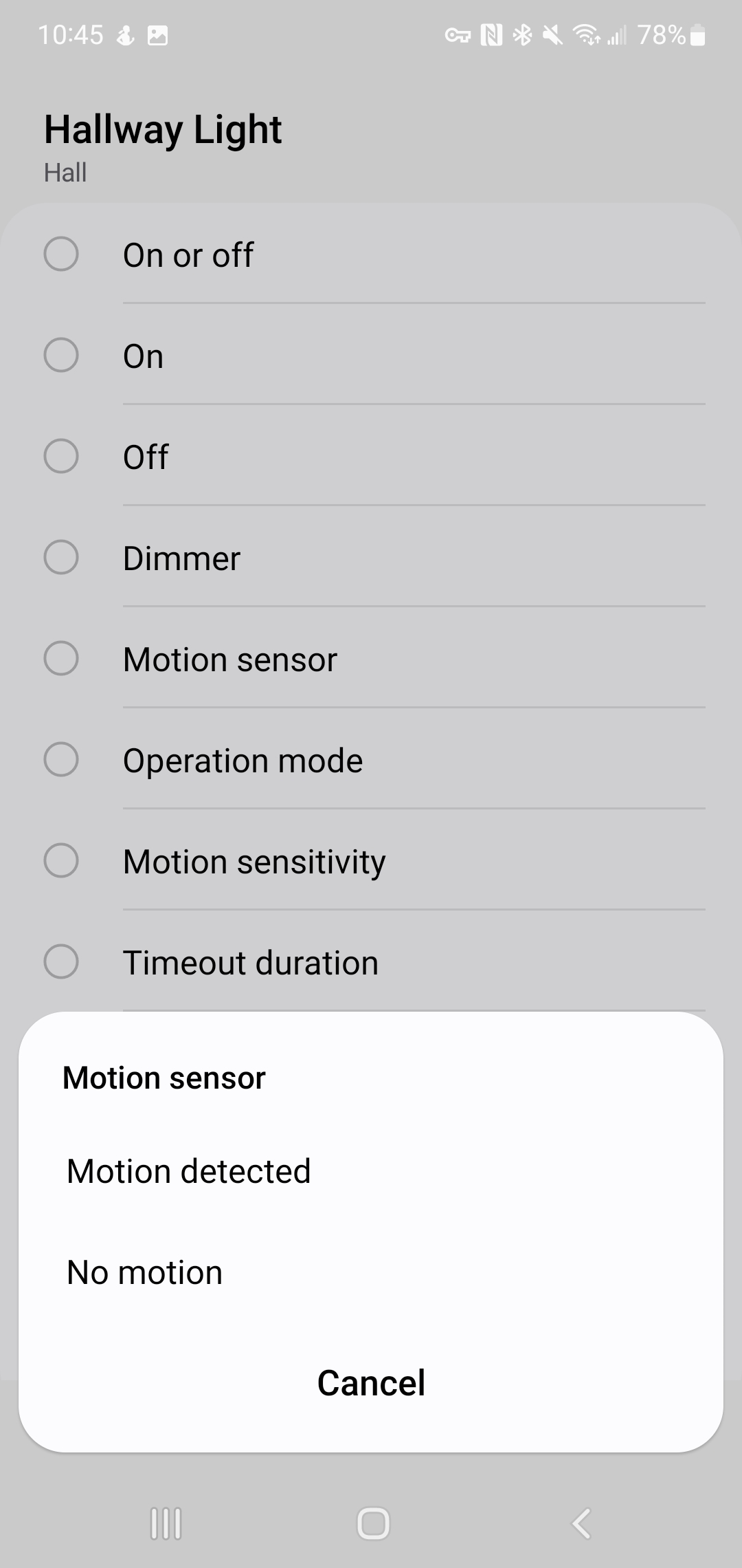

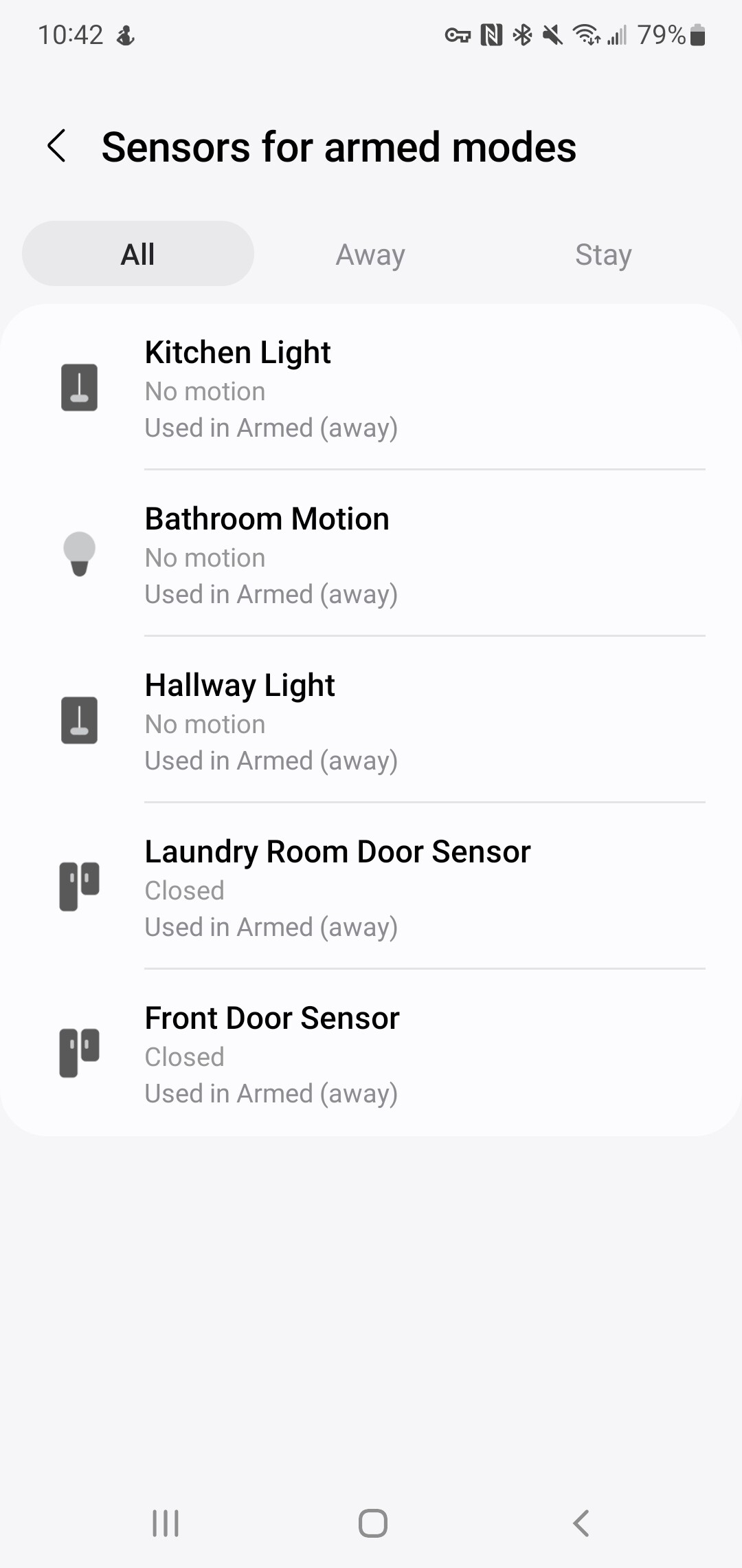

Good to know, thanks. At well over double the cost of the Kasa ones I bought I’m not sure it’s worth it since there is the virtual Motion option above. But clearly they are better and being able to directly see the motion state would be nice. If I end up getting any more motion switches I’ll look at Jasco.
