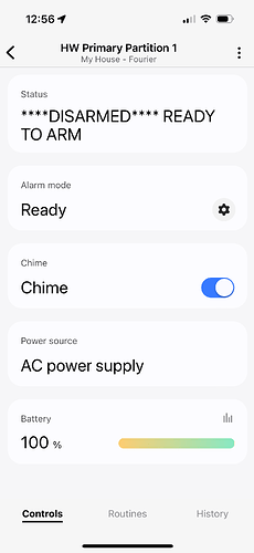

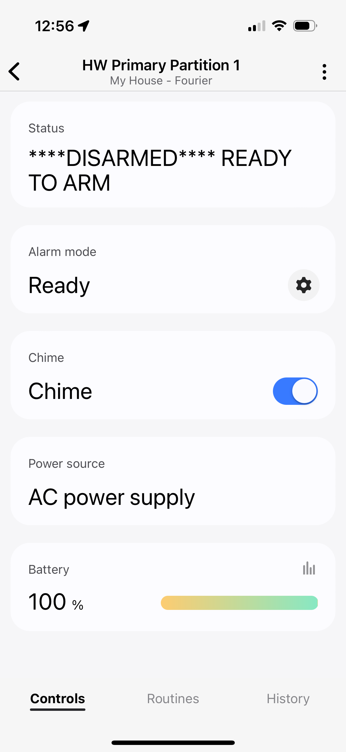

Honeywell alarm with envisalink 4 and app does what you want. Don’t know if monitoring is available for Honeywell in UK.
