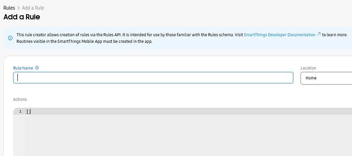

I am trying to make a very basic query on Advanced Web App Query for my Samsung Frame.
I have read all the posts with a solution but nothing works…
“command”: {
“devices”: [
“xxxx”
“commands”: [
“component”: “main”,
“capability”: “samsungvd.appControl”,
“command”: “send”,
“arguments”:
[“OK”,“PRESS_AND_RELEASED”]
The error I get is: 422 The request is malformed. Unknown target: Malformed body on line 1:194
Thanks a lot for your help

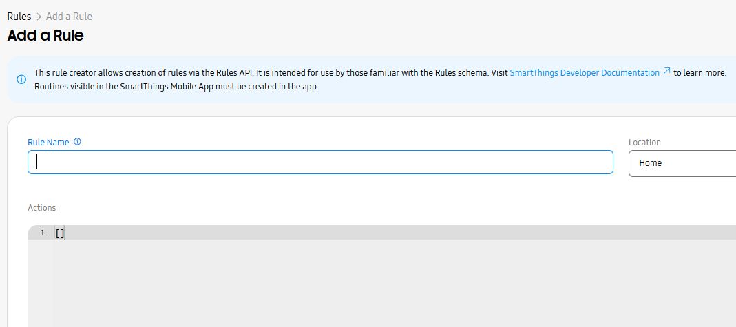

In the AWA, the outer brackets [ ] are already there. Try removing them from your entry.
Thanks a lot. I tried with and without and no luck…
You were OK with the square brackets in the first place. The ‘gotcha’ with the AWA and Rules is that is that it expects the value of the actions property which includes the square brackets. Why they don’t just let you paste in a complete Rule is a mystery.
It could be that it doesn’t like your arguments as the value should be an array of objects.
Try
    { "string": "OK" },
    { "string": "PRESS_AND_RELEASED" }
Thanks a lot. Unfortunately it does not work either.
If I include the “” it will give me: " 422 The request is malformed. {“component”:“main”,“capability”:“samsungvd.appControl”,“command”:“send”,“arguments”:[{“string”:“OK”},{“string”:“PRESS_AND_RELEASED”}]}: invalid command"
If I dont include them it will give me : “422 The request is malformed. Unknown target: Malformed body on line 1:32”
