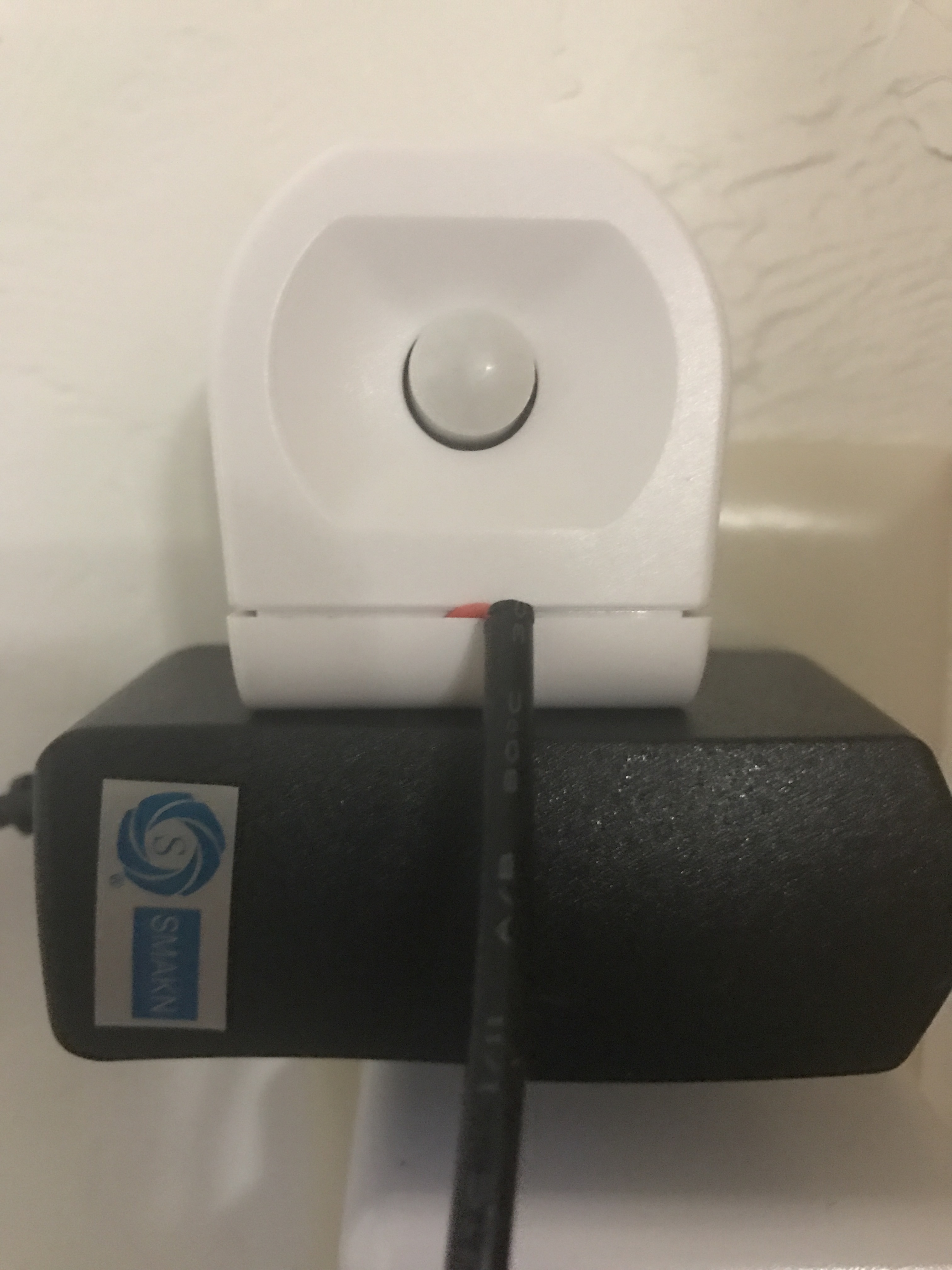

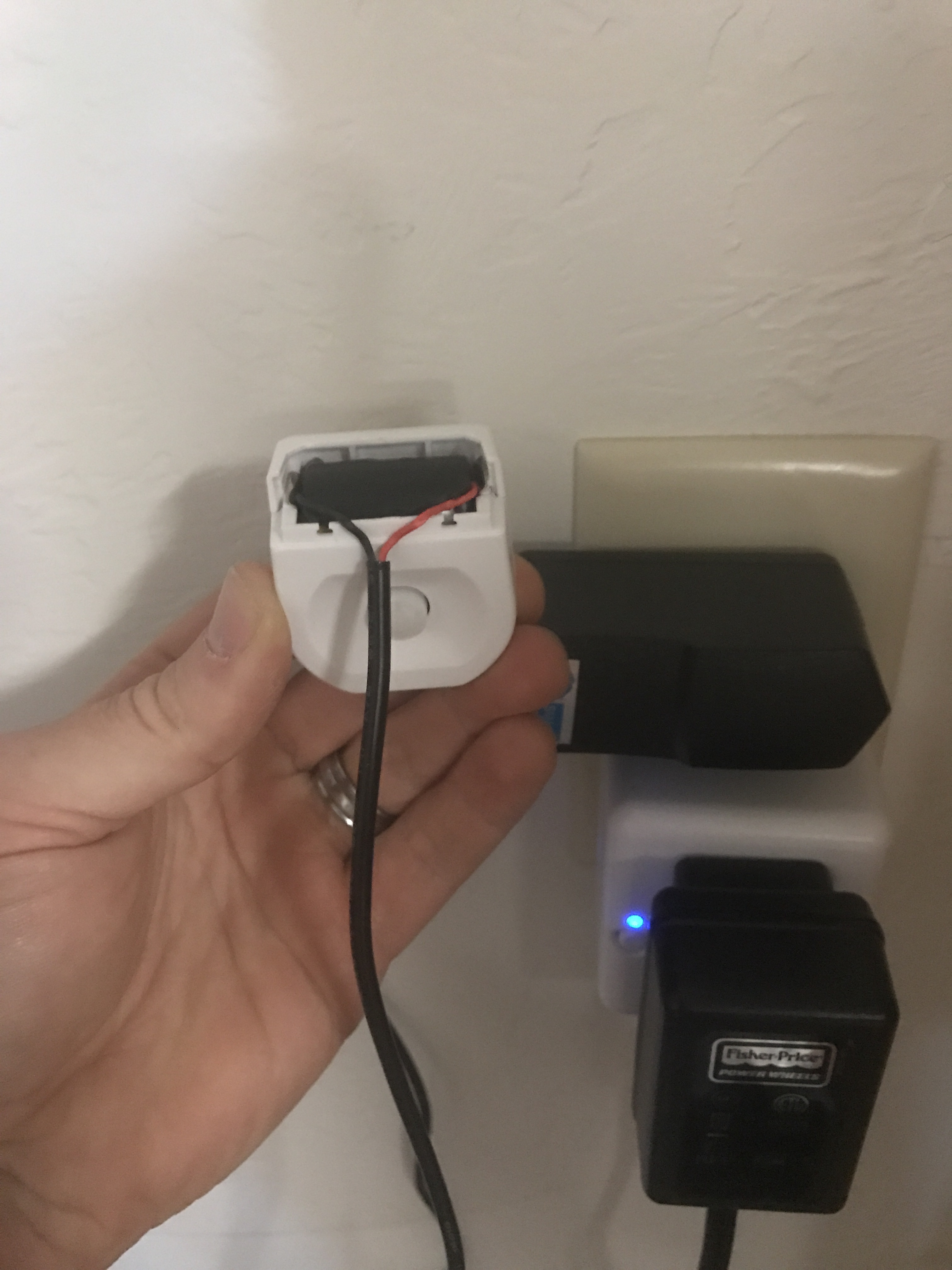

As far as just a battery operated motion sensor, you could always just buy a 3.3v wall plug, cut the end off, and hook the wires to where the battery would normally go. I tape up the a dead battery to hold the wires in place so it requires no soldering.
Totally diy and would void any kind of warranties.

This looks great! Can you still put the cover back one? I suppose I could use a large power supply like this and connect all the sensors??

Yes the cover fits back on this one without any modifications. Doesn’t look great, but I’m sure I could get a better fit modifying it a bit with a drimmel, and have it come out the back.

Guess I should have been more specific. I tape up the battery all the way around/ top and bottom with electric tape so that it doesn’t contact the wires and gets no current. It just holds the wires in place.
