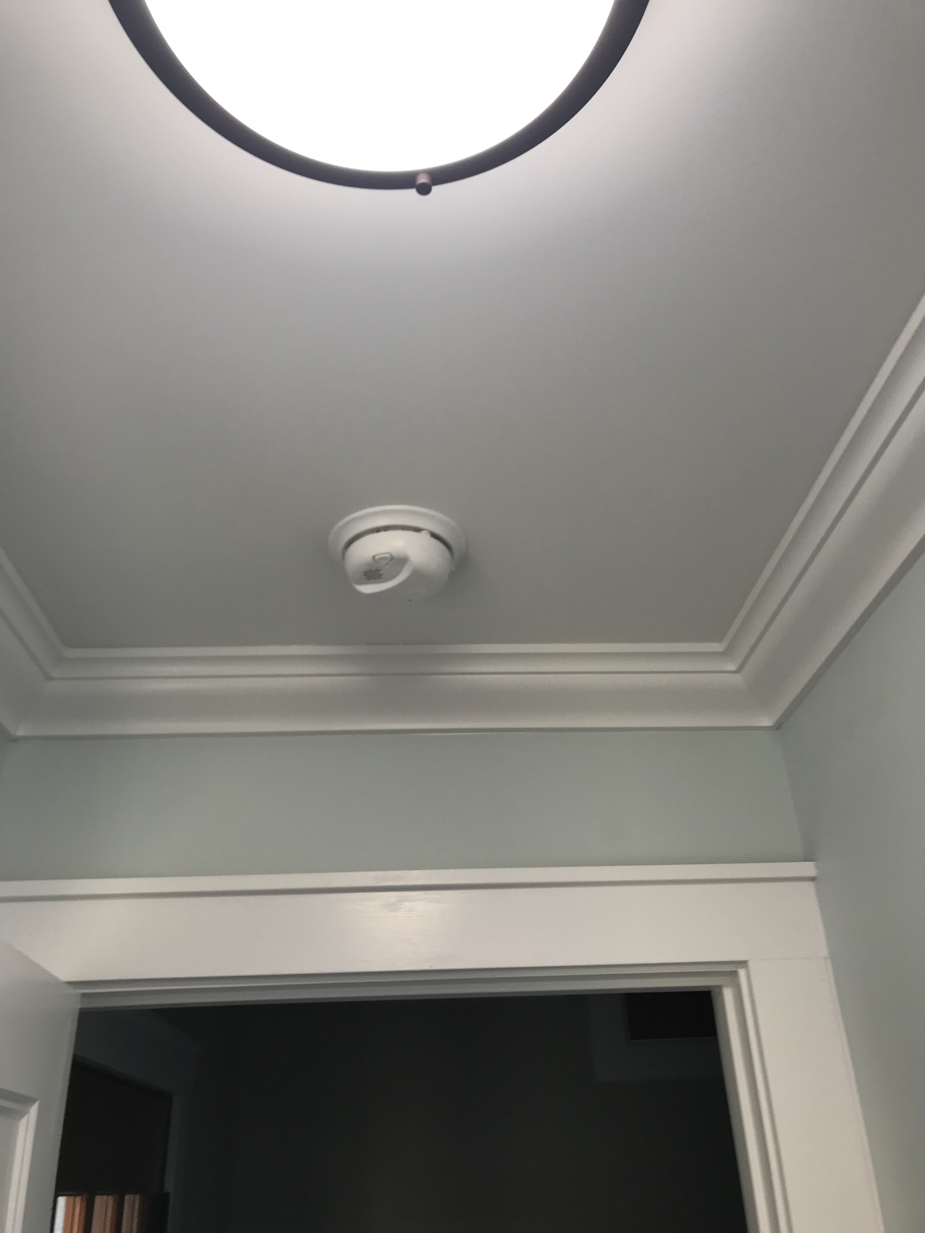

Been a while, but I am going on vacation soon and I wanted to get everything working properly. Here is my completed Smoke/CO sensors. all tested and working (multiple times and ways). If anyone else stumbles across this thread, Id be glad to describe the process. Thanks to everyone that helped me…
Before

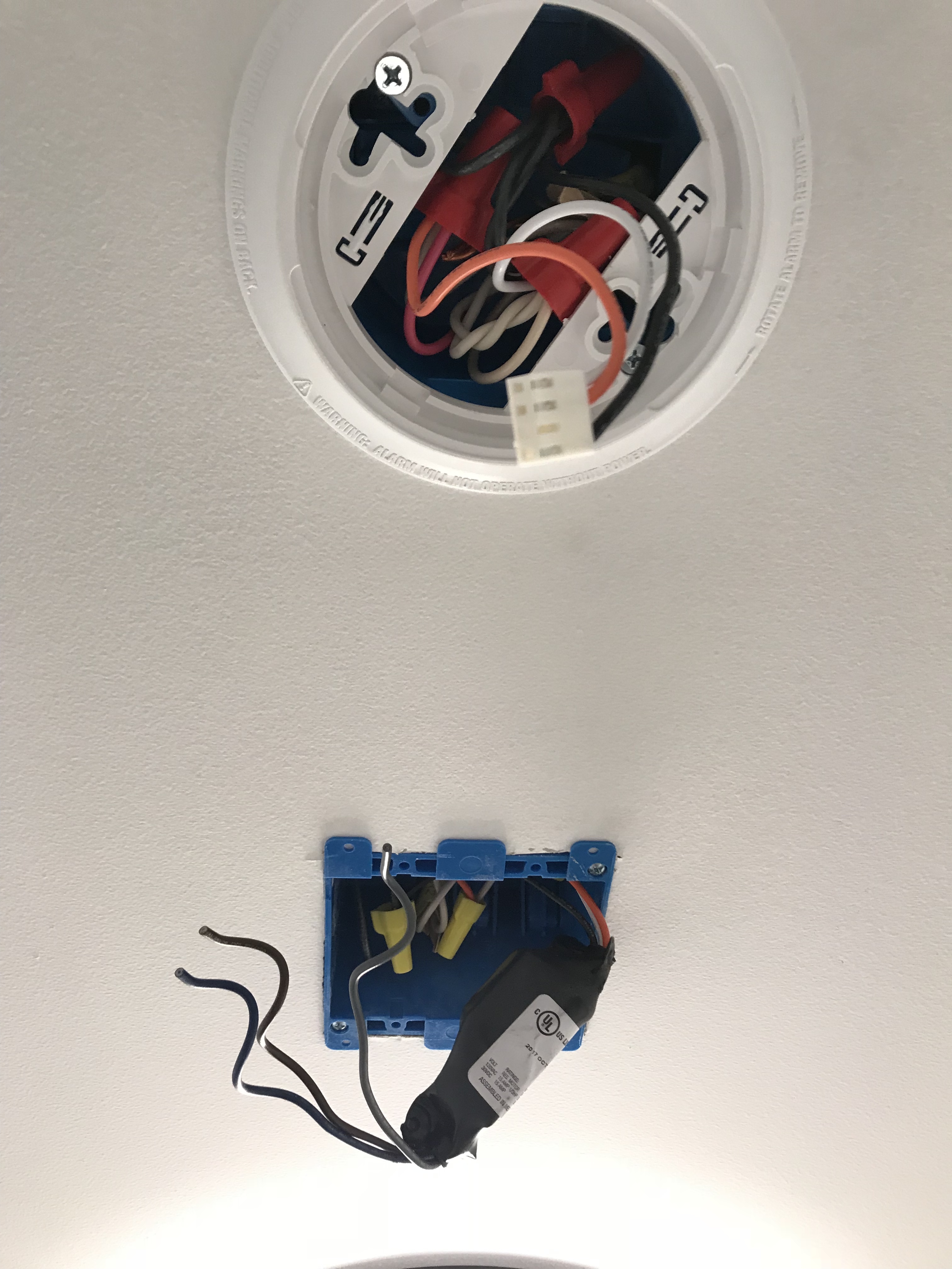

cut a big hole in my new ceiling
double box installed and wiring mostly complete. had to jump a 14/2 from the detector that was already in place and bring it into the new box to hook to the switch.
open/close sensor installed (I used the normally open circuit for my installation)
after everything was installed and connected, I changed the sensor over to use the custom device handler and then tested it all again (smoke test and magnet test). Everything works like a charm. PS my brushless cordless drill kept setting the sensor off while i was screwing it all together.
