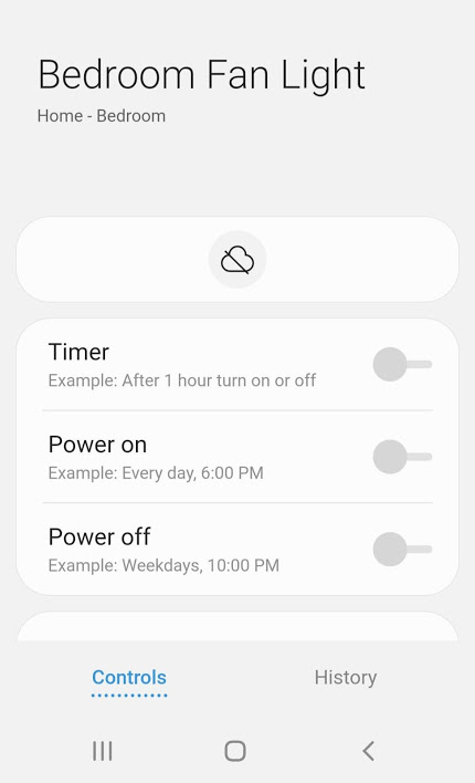

For a fan that shows connected with the old DTH but doesn’t work in the new app, all you should have to do is delete the child devices and then switch the DTH to the new one. You will have to delete any associated routines, or at least delete the child devices from it before you can delete the child devices. Deleting the child devices includes deleting the light (I wasn’t sure about this but yes you have to, if you don’t it will look right but it will always show disconnected). After switching over to the new DTH, I deleted the old DTHs from my library but I don’t know that it was necessary. It should create a new light child device and everything should work after this.
That worked for one of my fans, but the other wasn’t showing up connected in the new app at all. I had done some work on that circuit earlier in the month and the breaker flipped a few times due to a faulty fixture, so I suspect that messed it up somehow. It worked in the old app but not the new, so who knows. I tried everything above and it did look correct and it created the child light etc but did not work as it would not show connected.
To get it to work, I deleted it completely - both child and parent devices, the whole thing. However I did NOT exclude it. I then flipped the breaker and left it off for 10 seconds, then turned it back on. I went into Smartthings and put it in pairing mode and it found the fan and the light, and now everything works great. I saw a suggestion somewhere that this might work to fix the connection and it did, and I managed to avoid flipping the breaker on and off 5 times. For anyone having connectivity problems, this is an easy thing to try first. I tried repairing the zigbee network first and that didn’t help at all.
