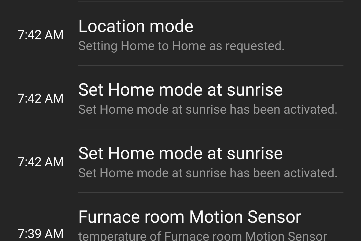

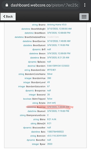

I also noticed another thing with sunrise time in new app, in which it only updates once the sunrise time changes more than (and equals to) 5 minutes. i.e., it will stay at 7:42am in Toronto for a while until next time sunrise is changed to 7:37am. Today in my area, it is supposed to be 7:40 or 7:39, according to IDE, webcore, and internet:
While this is not a big deal for me and for most of the people, people who are relying on sunrise time to do their Automations in the new app would definitely struggle because of this.

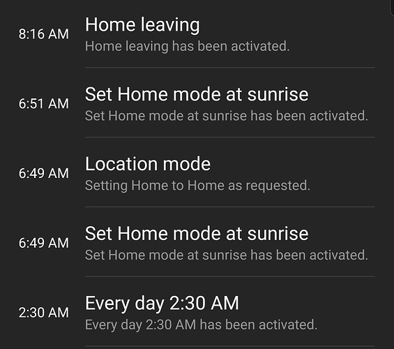

I don’t see 5 minute jumps in sunset times at all.
I’ve got a set of outside lights that are programmed via Smart Lighting to come on at sunset. Here are the times I’m seeing in the activity list in the STSC app:

What I’m saying is that from both IDE and webcore, sunrise and sunset actually changes everyday, wheres in Automations it stays the same for a few days:
