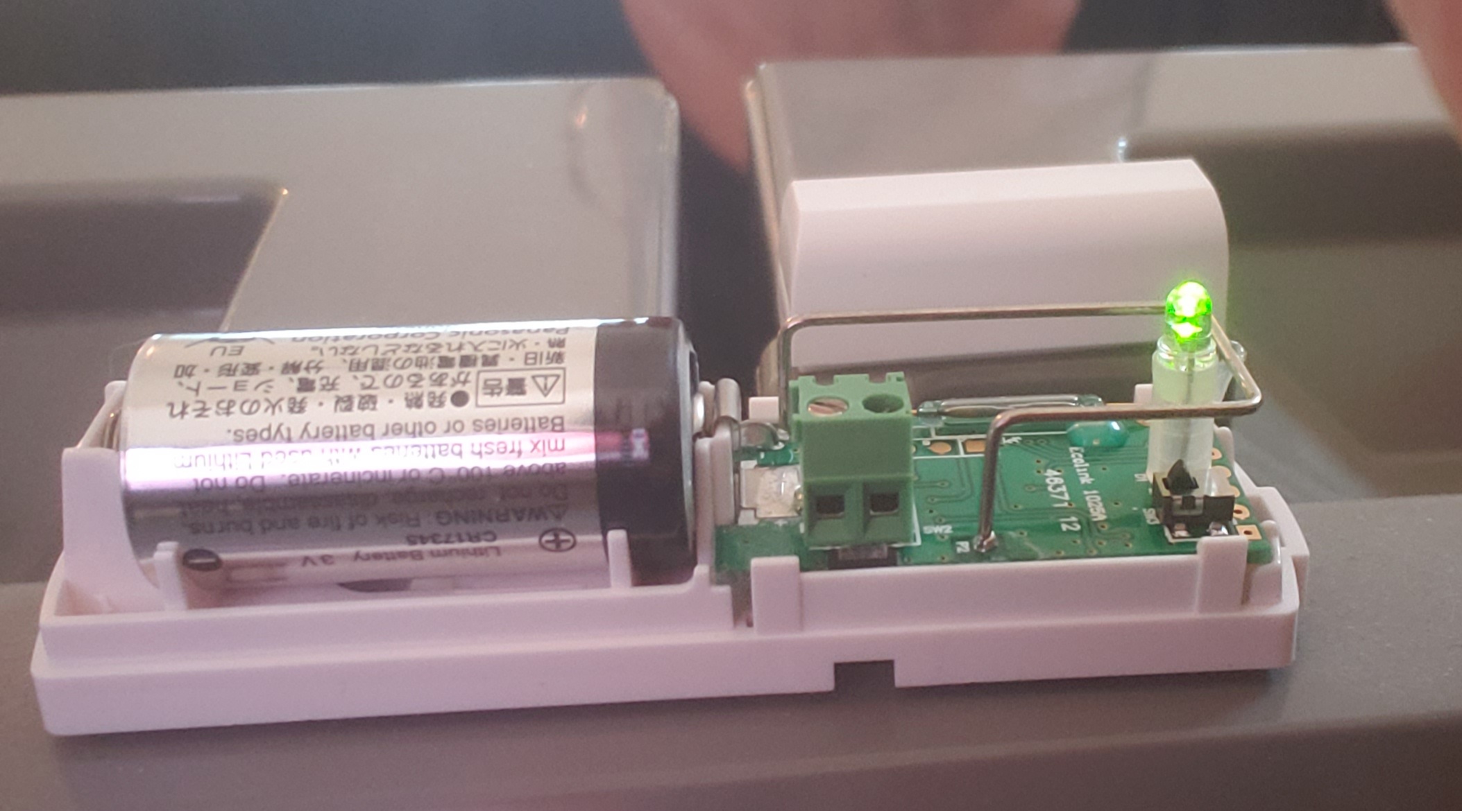

the ecolink does have secondary dry contacts inside of the cover. i am using several as door/window contacts and they work well with a relay, that i use to monitor power circuit branches. you should be able to use just the power relay $7. one side the live wire 12-24v connects to and the other side connects to the ecolink internal secondary terminals. the point of using a relay is that you cannot connect a live wire directly to the ecolink terminals, just open or closed (short terminals). note that using the internal secondary terminals may or may not require the magnet to be against the primary ecolink sensor. when the power is on the relay is closed, shorting the contact terminals together; when the power is off the circuit is broken thus the contact terminals are open.

Just to close the loop here, I’m back where the EcoLink is. There are a set a terminals inside, but the documentation doesn’t discuss their use.
