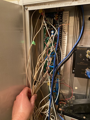

@leefl I’ve got an NX8V2 with NX216E. I’m trying to drop my home phone and make this alarm smart. I have Alexa’s throughout the house. Can you suggest what I need to make this work?
Also, what happens to my current keypads? Will they stop working?
Hey Chuck,
With my system you’d need an NX-584e comms module to connect to the NX-8v2 (since only the NX-8E panel has the comms on-board). Unfortunately the NX-584e modules are becoming scarce though there are a few suppliers out there that still have stock. (and a few folks have replaced their NX6 or NX8v2 with an NX-8E and then sold their original main board rather than buying an NX-584e, and probably saved money that way)

Thanks for the response @LeeFL. Can you point me in the direction of the NX-6E or a NX-584E? I’m assuming that I would change the whole board out if using the NX-6E? Would I keep the expansion board? I’d like to move forward if you can help me round up the parts. Also, are you looking for a beta tester for your new product?
Yes, for switching to an NX-8E you’d change the main board, but keep the expansion board.
The NX-584e is an add-on for your existing NX-6v2.
My previous supplier of the NX-584e has been unable to get more stock recently, but I’ll see what I can find (though I wouldn’t have any experience or direct recommendation for any suppliers I find). I’d also suggest searching for those two boards yourself, to double the efforts :wink:

I found this one… would this work?
“ Interlogix NX-8E-BO-FG NX-8E Board Only”
