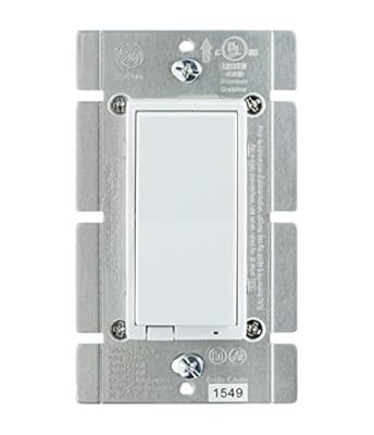

Getting ready to order a few of these. I know I will need the in wall dimmer for my lights. I will also need in wall fan control for my fans.
2 questions. What is the 1000W dimmer for? What is the ADD ON switch for?

The 1000 W dimmer can handle a larger load than the 600 W dimmer. It’s really that simple.
People most commonly run into this in kitchens where they may have banks of lights controlled by one switch because they may want to have the option for a very bright workspace.
The add on switches are used in a 3 way set up where two different switches control the same light fixture.
For example, there might be one switch at the bottom of the stairs and another switch at the top of the stairs that control the same lights. Or one switch at each entrance to a large room. The master switch controls the current load to the fixture and the add on switches (also called auxiliaries or slaves, depending on the brand) just send an instruction to the master.
If you have a three-way set up, you need to make sure that the auxiliaries are the ones specifically designed to work with that master, as different models use different methods for doing this.
If you want speed control from the switch for your fans, you must get a switch specifically rated to control fans. You can’t use a dimmer light switch or you will burn out the fan motor.
