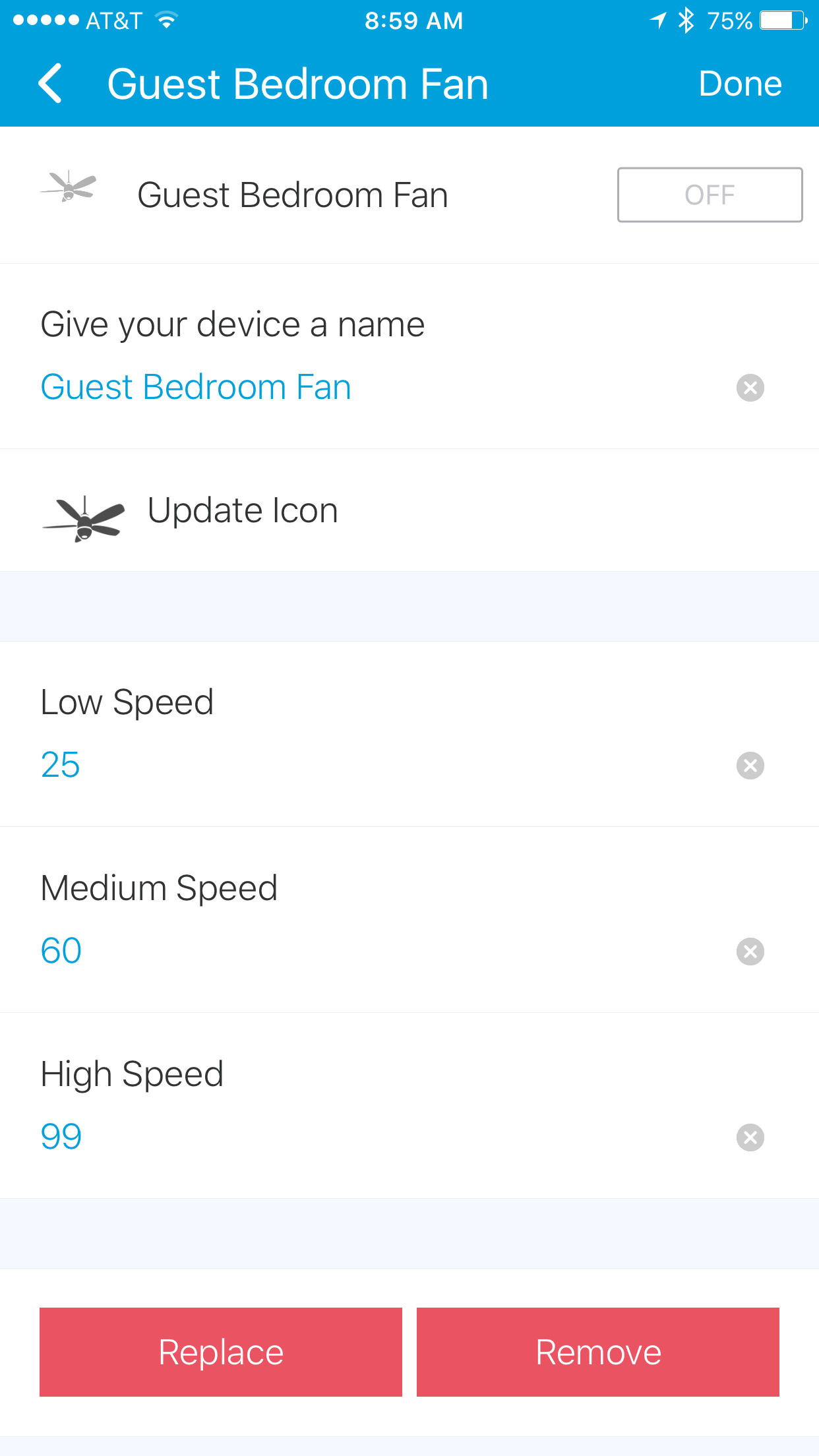

Here is the ink for the DTH I wrote for fan with levels. It allows you to set custom values for the levels and exposed the low/medium/high to webCore:

Patrick thanks for your contribution here. Been tinkering with yours for a few days. Sometimes the app doesn’t match with what the fan is doing however, and when making changes at the physical switch doesn’t always show the correct speed on the app. However I’m in the early stages of tinkering and I’m not quite sure what to set the percents to.
Also there are two versions it seems in this thread, yours and the original. What are the main differences? I’m using webcore with yours, is that why you wrote it?
Any plans to update it?
@mismarthome I have not experienced the issues you are suggesting. The main difference from the original one ad the one I built is the UI as well as the ability to set your own values for low/medium/high as they were hard coded previously and yes I added the code for use with WebCore.
Hey thanks for this device handler. It’s great! I was looking in to tweaking this to support setting the threshold for high to 100%. Is there a reason why? It’s a bit awkward in homebridge/homekit because we can’t.
@leblaaanc if your using the original one I don’t believe he built it with that, if you use the one I posted it provides the ability to set each level.
