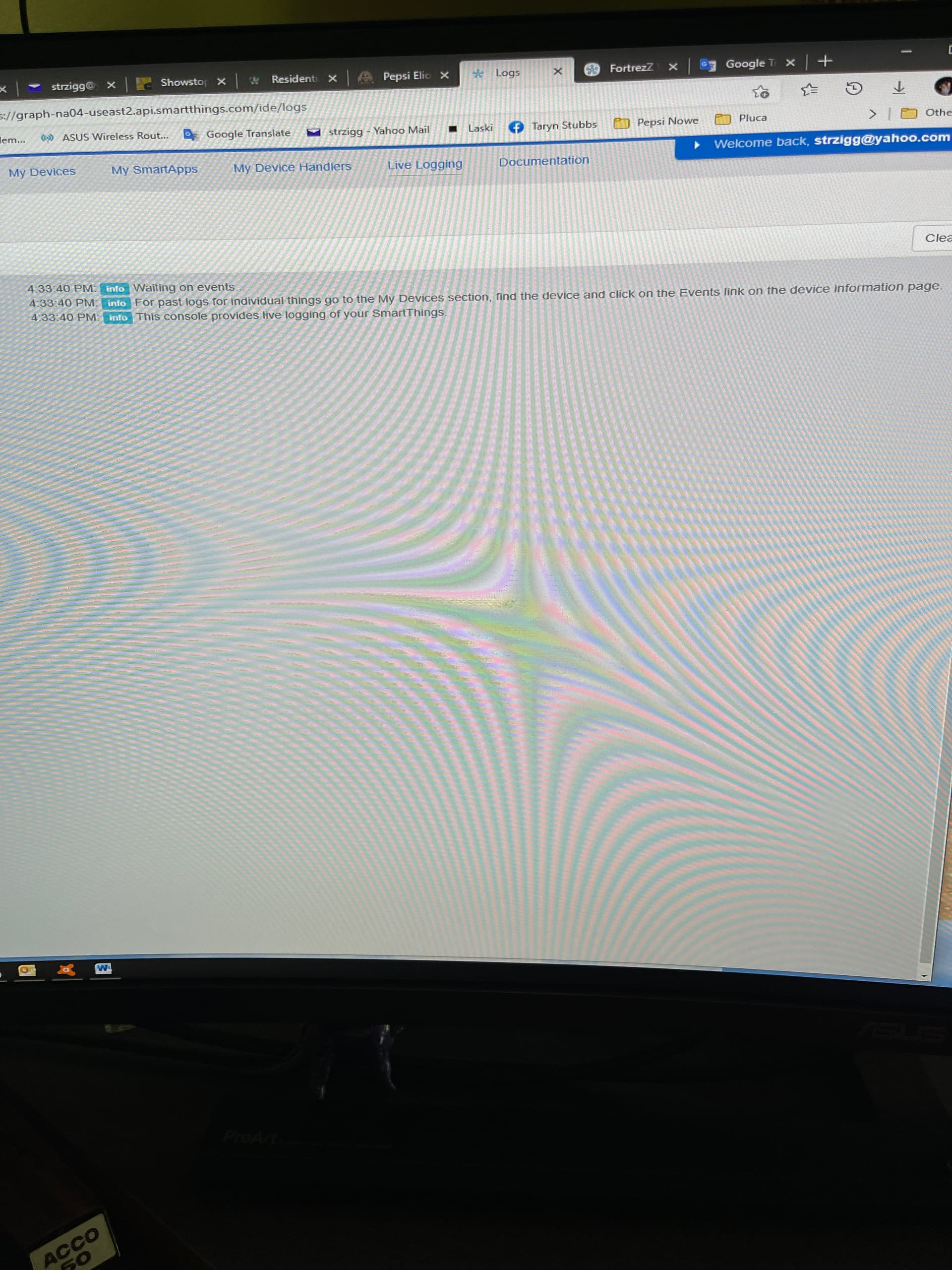

Your live logging isn’t doing anything because you’re not running water through your meter perhaps? Did you enable debug logging in the device’s settings?

Can you please watch Live Logging while water is running and let me know what it’s reporting? It should look like this:

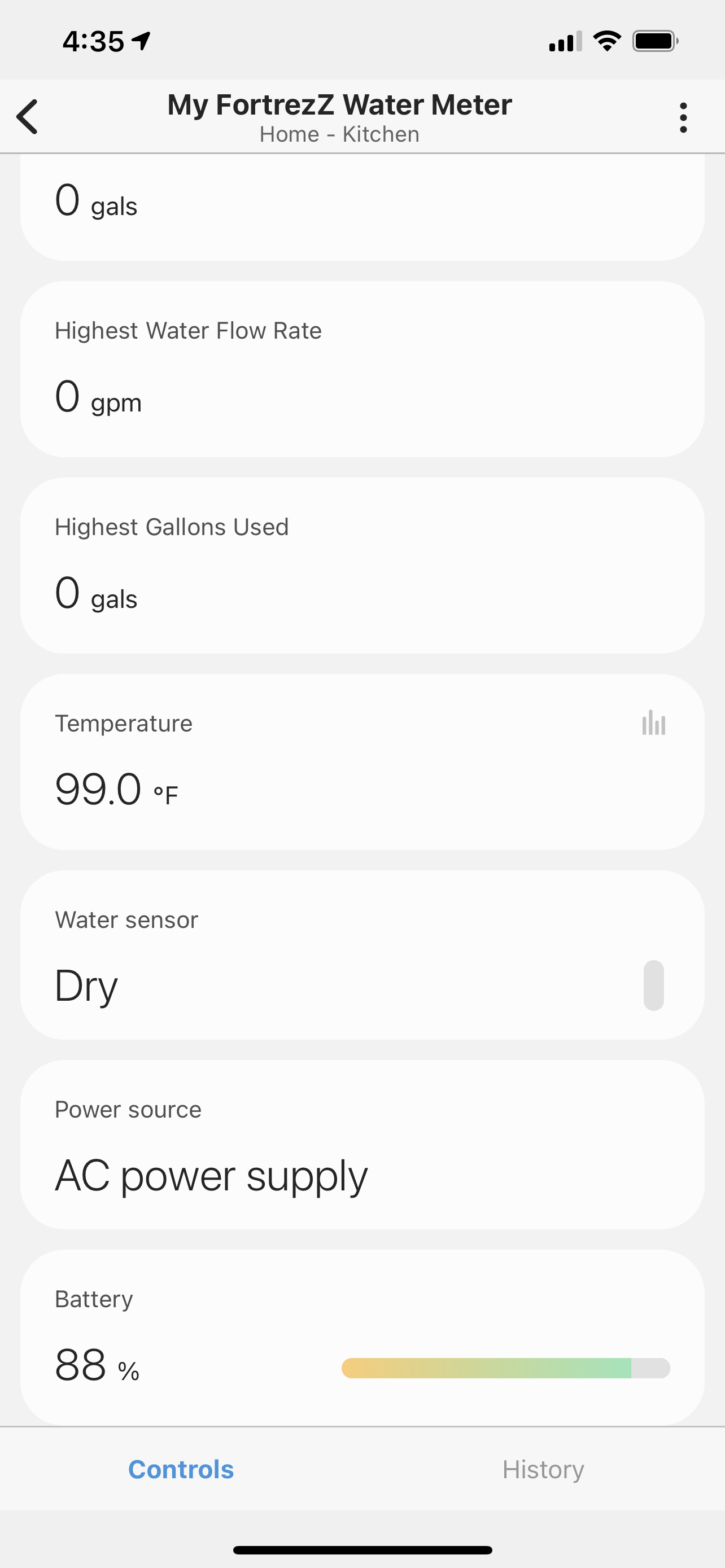

Nothing is goin on but I can see in iphone appAC power battery % so I think Im conected by FMI to the meter?
Something isn’t right. Live logging must show events coming from the meter when water is flowing.

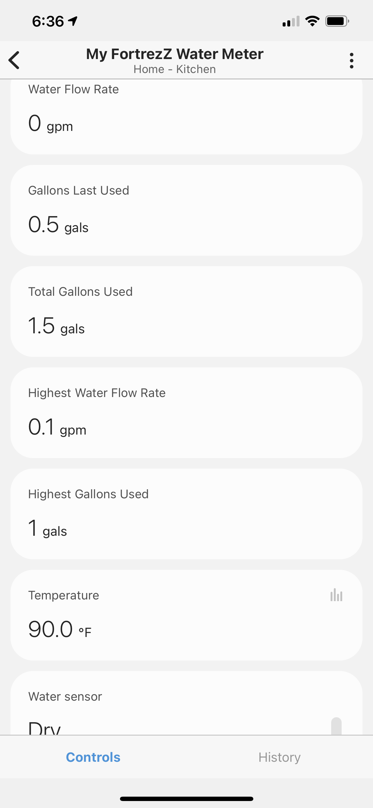

I’m looking back at the images you’ve provided, and something isn’t right.
What changed from this one:
to this one:
In the first image, it looks normal and the meter variables have data, which means it’s communicating to ST and working. Even your image below shows me it was working because the variables in the Current States section have real values:
This historical values you can see from the images above from the IDE and your mobile app don’t align with your latest image from your mobile app in your last post. Did you reset the meter or remove it and add it back to ST?
