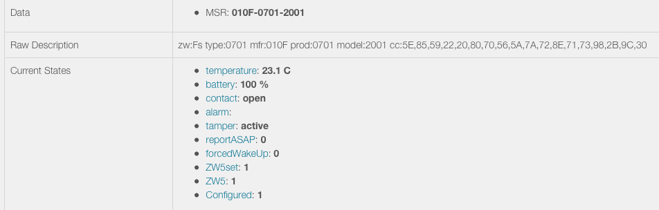

I have a v2 hub. Right now I’m just trying to get a temperature value. Temperature probe was added prior to pairing. If everything is working properly should the Current States field on web graph.api have a temperature field?
I would love to find out how to validate that the switch physically recognizes that the temp ds18b20
Thanks for the quick response! Still no go. I’ve tried 4 sensors so far. Un-pair from hub, remove battery, attach new probe (red=power, blue=data, black=ground) verified that connected to correct pins. At this point I’m concluding that I either have a partially bad Fibaro switch or bad probes. Ordered new of each from different source than originals now working with. This for a freezer alarm so willing to spend a few extra $$$ to get this working.

Good news, it was the temperature probes. Using your device handler I now have 2 functioning units properly registering temperature. Bought the probes from a different vendor.
For reference to those that follow, if the temperature probe is connected correctly SmartThings will recognize the unit as a “Fibaro Door/Window Sensor ZW5 with Temperature” when paired to the SmartThings hub
Easiest to install the sensor before activating the unit for the first time (pulling the cardboard battery tab) otherwise, you can do a firmware reset by following these instructions.

Great news on the update bug. I’ve never updated a handler before. Presume I just cut and past it in, save and then publish to myself. I am not getting a value of 1 for configured after 10 minutes, is there a step I missed?
Thanks and I apologize for the noobie question!
Edit: Never mind, it eventually refreshed and updated the configured value to 1.

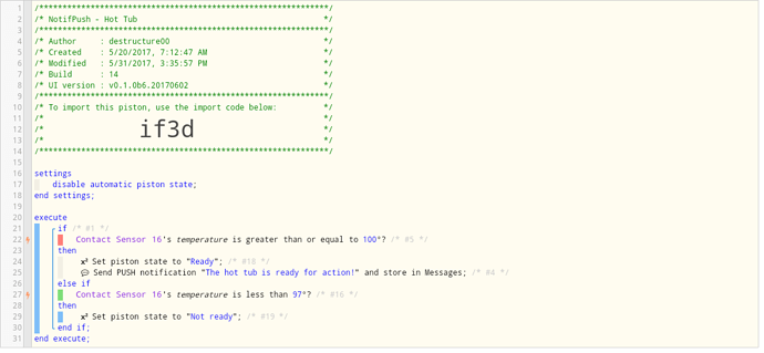

@bturcotte : Well, sadly, the outside pool is definitely too cold for me…
Note that the latest ZW5 version of the FGK-10x could be programmed to generate a “High Temperature Alert” whenever your Hot Tub temperature goes above some value (parameters #54 & #55) : that could avoid you being overcooked like a lobster if your water heater goes wrong…
