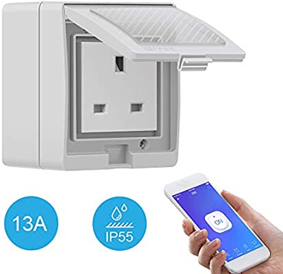

My use case is an outdoor strip of light bulbs. I’ve not found any outdoor rated dimmable socket here in the UK.
I suppose I’ll just have to wait for someone to develop one.
Why don’t you put your fibaro dimmer in an outdoor junction box between the plug from the lights and the lights themselves.
I’ve bought this. Doesn’t dim, but at least it’s smart and out door rated.
I am considering at some future point getting smart outdoor lights but currently leaning towards using Philips Hue garden lights. These can be controlled via Smartthings and are specifically designed for outdoor use. They would be wired direct to mains and I would route the cable in an underground plastic pipe.
Does this work with ST ?
The new Smartthings app has ewelink as a supported app. But I didn’t use it, I’m using the standalone app.
Ah ok, ordered one, lets see if it works with ST.
Ok, i found this :
SONOFF smart home devices now interoperate more easily with Samsung SmartThings - SONOFF Official
According to that, S55 should work
Need to try that when i get home
Edit: ok cool, seems To work!
