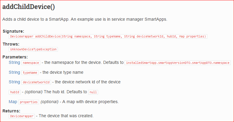

We should be able to spin these up on the fly with “addChildDevice()”…
Unfortunately, “addChildDevice()” seems to require that “typename” be a Device Type in your own Account, even if you specify “namespace” of “smartthings” … No … it must also search the officially “published” Device Types, right, and “Virtual On/Off Tile” must therefore not be published (unlike the “Hue Bulb” child device type, for example).
@slagle? @Ben?
