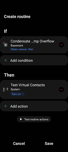

Actually I use mine connected to the overflow switch on my HVAC condensate pump. So moisture is what I want.
For other uses I would create a virtual device for whatever I want it to report. The I would use 2 routines to connect them. The other option might be to download the Edge driver and tweak it to show what I want.
