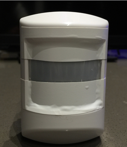

After a lot of trial and error the best way I’ve been able to avoid false triggers is to place the motion sensor about 4 feet of the ground (same height as mid torso) and adjust the field of view horizontal or slightly up to avoid seeing the ground or animals.
The Ecolink work very well but the field of view covers high to low and by placing electrical tape over the lower half the ground hit by sunlight is blocked by the tape.

  2. Tape on a normal motion sensor to block of ground and sky: FAQ: Do you know of an outdoor motion sensor? - #50 by BrianEliot
    (Won’t work for me, to much moving green)
