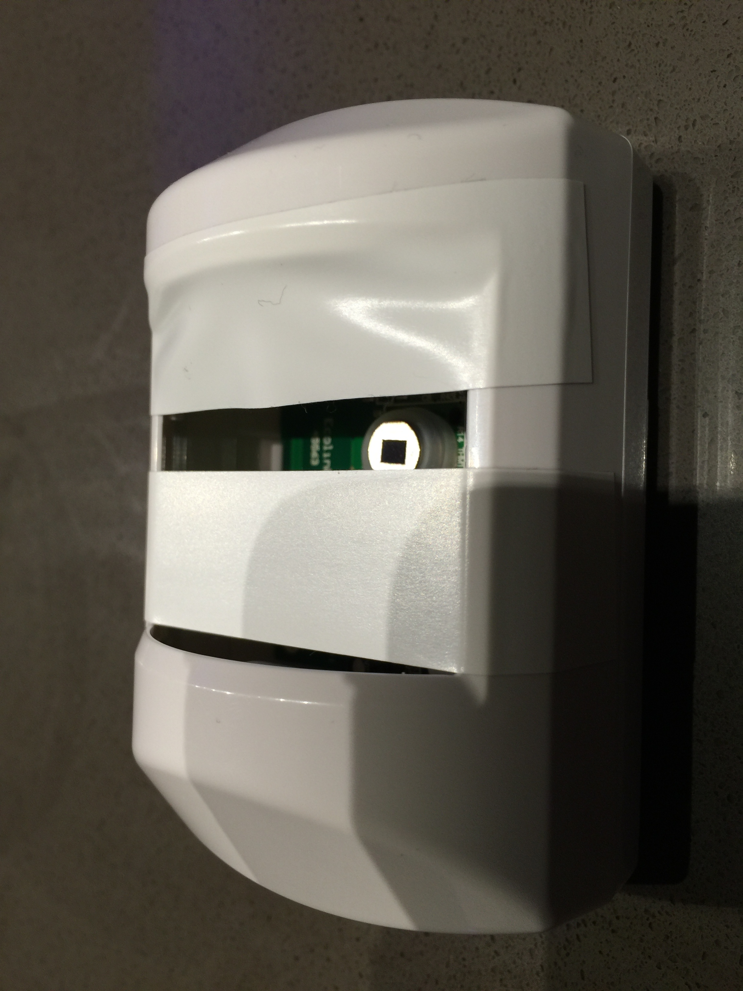

Here you can see PIR sensor.
Align the tape without the lens for the best straight out horizontal view.
Inside with the lens and tape.
Looking through
With the tape in place blocking out the ground and sky.
Tape up and any holes and joints to reduce water, bugs or spiders from getting inside.
