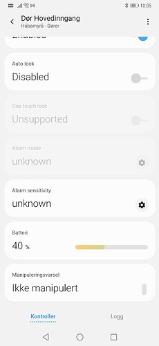

@RBoy Any plans to bring different VID to different locks like you do on other DTH?
So we can get a more clean display and remove any unnecessary/unsupported tiles for different locks. And add more features like the smoke sensor for the ID Lock.
I also see that you dont have the automation section defined for you custom capabilities. Any plans to add this so we can use the built automation tool in the ST app for custom capabilities?
This DTH VID uses a more advanced conditional display for its controls, so they shouldn’t show up when not supported which makes this very flexible and future proof. However conditional displays are broken and it’s still pending a fix from ST. Maybe @nayelyz can provide an update on the status on conditional displays in VID
Something has changed now. But not all unsupported tiles are greyed out
