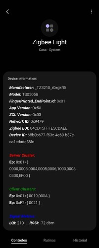

During my recent stay in Germany, I brought to Spain a Zigbee mood light from LIDL:
If you could take the time to add this model to your light controller, I would be very grateful.
It has a built-in battery, but I don’t know if it is possible to attach a battery status report function to the controller? If it’s not possible, just being able to control the light would be great.

Hola @norberto_bcn
Added to this driver version
 Name         Zigbee Light Multifunction Mc
 Version      2023-06-05T08:37:24.507396657
- id: "_TZ3210_r0xgkft5/TS0505B"
    deviceLabel: RGBW TS0505B
    manufacturer: _TZ3210_r0xgkft5
    model: TS0505B
    deviceProfileName: rgbw-level-colortemp-2000-6500
It doesn’t use the standard 0001 cluster, it may use the EF00 custom cluster to report battery, but I’m not sure and I don’t know how to handle it either.

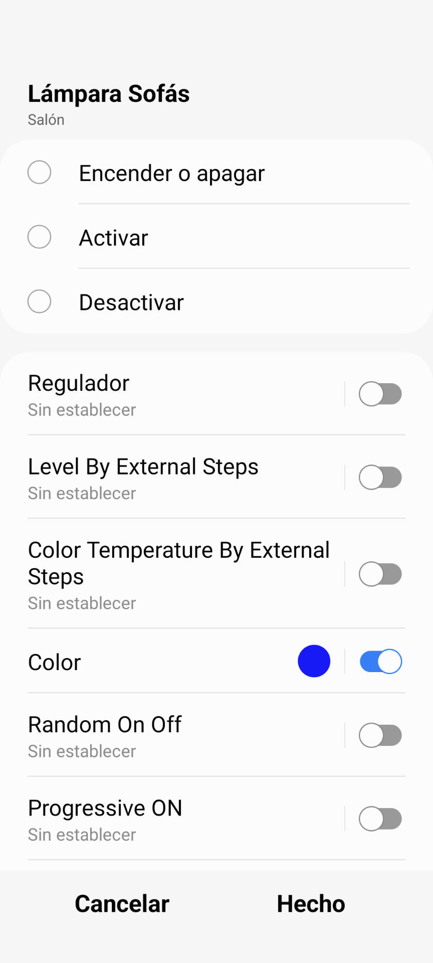

@Mariano_Colmenarejo I have been using your drivers to run all my lights and I am very happy with it.
However, I have one issue with them: if they are turned on by a routine, the bulbs don’t take the new colour settings in the routine. They start with the correct brightness, but always retain the colour settings from the previous time it was on.
I have tried using On/Off in the routines, as well as not using On/Off at all and only using the dimmer settings (dimmer 0 for off, dimmer 70 for on, etc., with no selection in on/off). But the colour is not changed from the previous time unless I manually set it again, or another routine runs when the light is already on.
How can I fix this? Thank you! :slight_smile:
Hi @rowschank
I don’t know what your routine is like.
It works well for me like this, it always lights up in the color of the routine, regardless of the previous color in the bulb
This is what my routine looks like and it is activated when the bulb is not on.
Brightness and colour changer settings apply directly but not colour settings and always starts with the previous colour…
I’m sorry, I don’t know if you’re talking about color or color temperature.
In your routine you are not sending any command to set a color, you are sending a command to set a color temperature of 3500k.
I have tried it and it works fine for me, it finds 70% and 3500k and previously bulb was in red color
