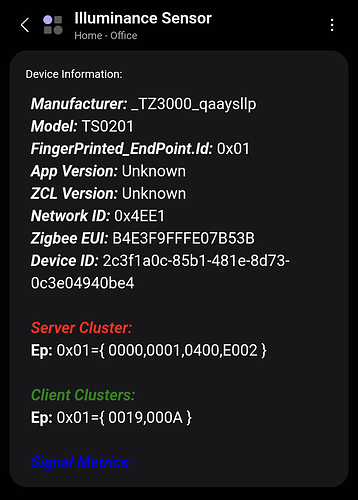

Thank you. I installed the driver listed, but when I try to change the driver I only see the Zigbee Thing MC. It is being picked up by the hub as only illuminance sensor. Battery is listed but does not report.
Re: the clusters, I’m too much of a noob to get this right, but this link to the ZHA device handler lists them all, I’m just unsure of what is needed. I understand from this thread that this took some digging by others to get to the correct cluster information.
Other user already asked me in October if I could add this Tuya device. This manufacturer sometimes makes their devices work in a non-standard way with Zigbee, I suppose to try to get you to use their app and platform.
It is a strange device, since it does not show the clusters of temperature 0x0402 and humidity 0x0405, it seems that they are hidden in an endpoint 2. So smartthings does not find them during the installation and does not configure them.
I could do a test and try to manually configure the temperature and humidity for endpoint 2, but I don’t know if it will work and therefore I would suggest the same as the other user, if you just bought it and do not plan to use it with the Tuya app, I would return it and buy another one that works more standardly with Zigbee, I’m sure there are clones from other manufacturers.

Try installing this driver version
uninstall device with app and reinstall device with this new driver version to device configure endpoint 2 clusters
 Name         Zigbee Temp Sensor and Child Thermostat Mc
 Version      2023-12-16T11:56:14.49849525
- id: "_TZ3000_qaaysllp/TS0201"
    deviceLabel: Tuya TS0201
    manufacturer: _TZ3000_qaaysllp
    model: TS0201
    deviceProfileName: temp-humid-illumin-battery
I am pleased to report that this integration does appear to be working! Interestingly, the device has never reported an accurate battery measurement on the LCD ever since the originally packaged batteries were replaced with rechargeable AA’s (shown as 1 or 0 bars only). However, it looks like this is getting an updated battery reading that aligns with my expectations.
I’ve been following this device for a while, and as you stated, it wants the “tuya magic” of being connected to a Tuya hub first, and hiding behind bogus clusters. It’s also been reported as very infrequent updates, but this appears to be updating very quickly with status changes!
Thank you for the support! This will make a lot of others happy that there is now a 2nd method to connect these devices!

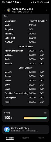

hello Mariano, i have bought this new Smart Door/Window Sensor from MOES. Could you please add it to your devices list please? Thank you in advance!
Hi @junkai21
Added to this driver version
You need to install new driver in your hub
Uninstall device an reinstall with this new vesion to device configure
 Name         Zigbee Contact Mc
 Version      2023-12-22T11:41:39.355706092
- id: "_TZ3000_8yhypbo7/TS0203"
    deviceLabel: TS0203 Contact Sensor
    manufacturer: _TZ3000_8yhypbo7
    model: TS0203
    deviceProfileName: contact-battery-profile
thank you Mariano, i have successfully installed the sensor!

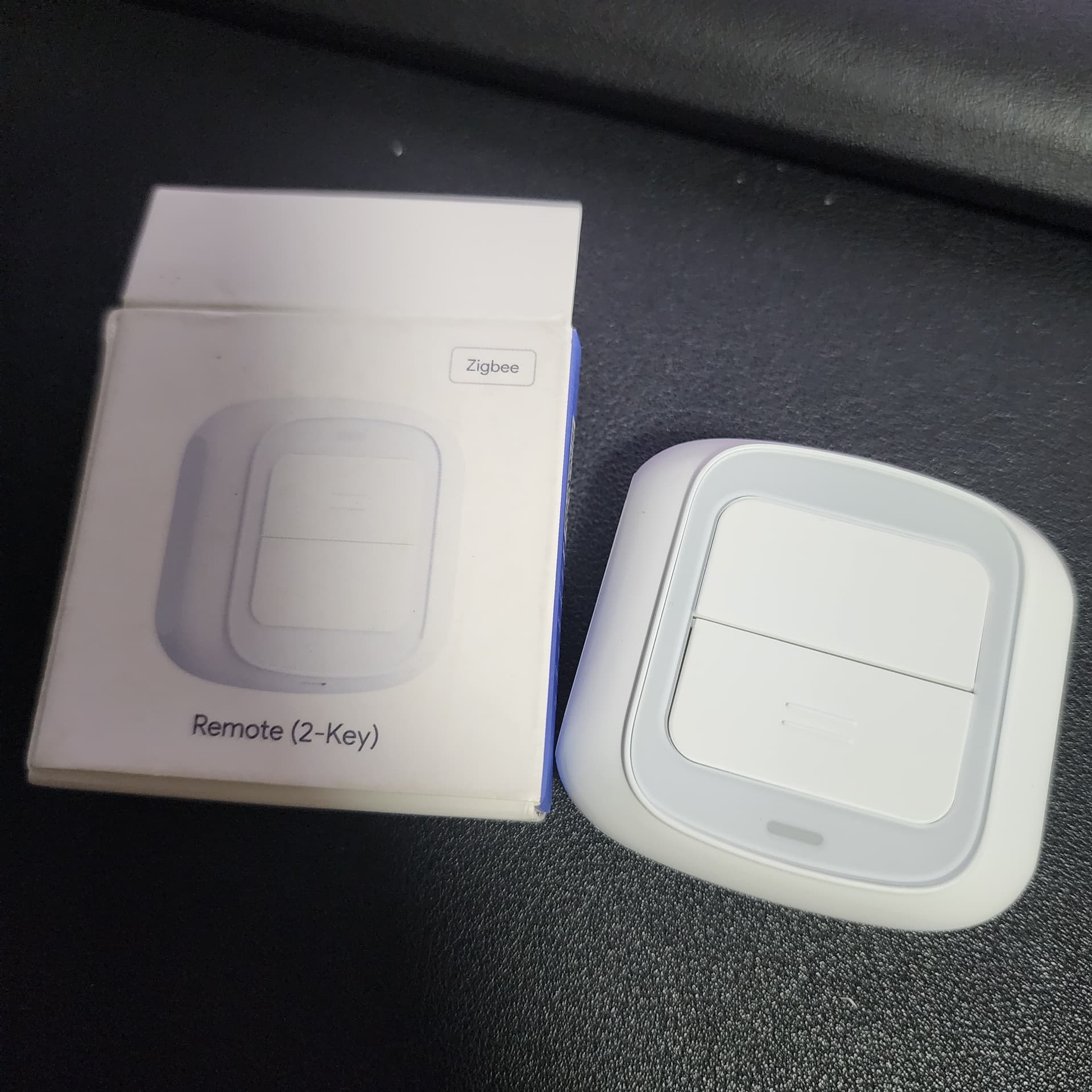

One last request, i have a 2 button device that doesnt work as well. Are you able to help me out? My home will be complete for the holiday season! Thank you!
Sorry, I have not any driver for zigbee multi-button devices

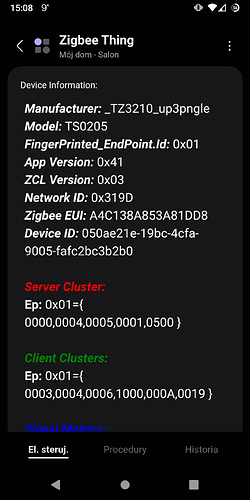

Hello from Poland. I have a tuya smoke detector YG400A zigbee but it is incompatible with smartthings. Maybe You have this driver compatible?
Hi @Zbigniew_Wypij
Pair device with zigbee thing Mc to see fingerprints and cluster
Sorry. Im new, have you link how to do this?
Mariano channel is here:
https://api.smartthings.com/invitation-web/accept?id=6b68563b-1905-4654-8d2b-e677a2997424
Enroll, and install Zigbee Thing only
Send a screenshot of what you with this driver from your mobile… .
Ok I have all data.
