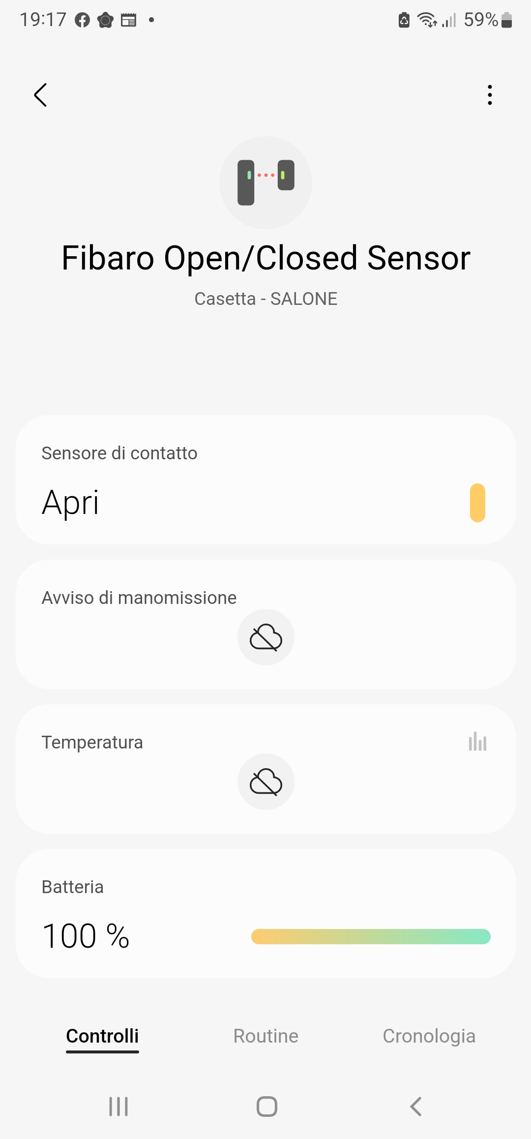

Try to heat the probe to see if it emits any temperature event, since the refresh of the app does not work.

Tried but nothing to do as before not showing signs of life β¦ the state does not work and neither does the temperature

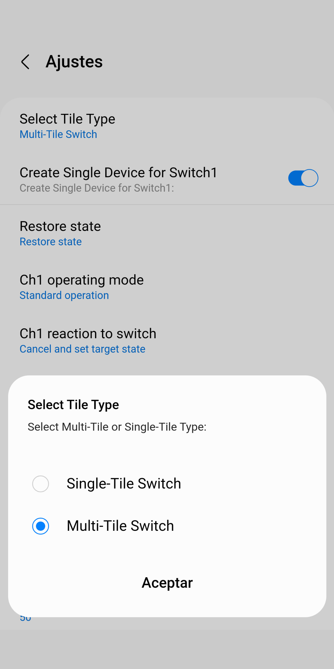

Question 2 see image
Also if you try to delete the driver and it deletes then it was not attached/used by any device. It will not allow drivers to be deleted if they are in use.

This one is a bit different because main turns everything on and off.
Switch1 and switch2 are endpoints 0 and 1.

Tried everything but nothing β¦ then it doesnβt work in any case not even the open or closed state and neither the temperature does not fit us ![]()
I have it now.
With the stock Z-Wave Sensor driver works the open/close?
