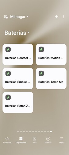

You can create a room with all child Batteries status device to group all batt information
