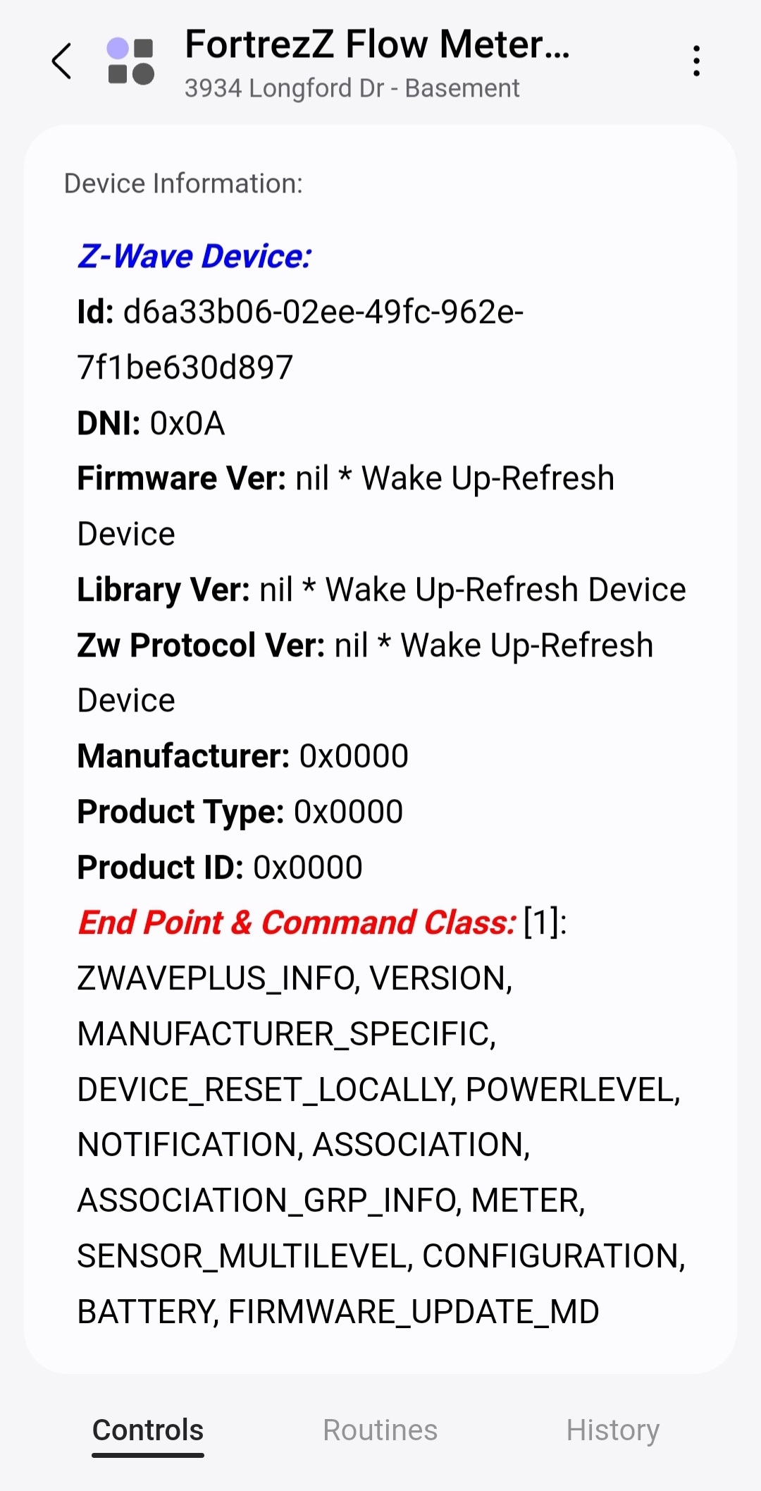

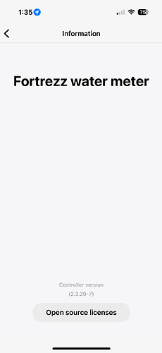

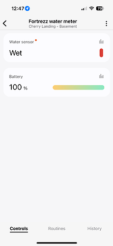

This is what i see
Whoa, you’re definitely not using my driver.
When you tap on those 3 vertical dots and tap on Driver, what does that show you?
The new link worked. I didn’t find the “Zwave Thing Mc” driver but I found what I think is the equivalent one (maybe updated name) called “Z-Wave Device Config Mc”. Here is what it shows…

No worries, and that helps a ton! The driver you selected also gives the similar info, so thanks for doing that.
This is the problem:
When the meter joined your hub it didn’t properly capture all that info.
We have a couple options. One, I can update my driver to add those 0’s fingerprint and then you’ll be able to use the driver; OR, you can exclude the device from your hub and rejoin it.
I can easily add that fingerprint for you, but there is a possibility of the driver not working properly if something else didn’t join correctly. If I remember right, this particular meter has been there for a while and working, right? If that’s the case, let me update my driver and get back to you very soon… Be right back.
The driver has just been updated to include the fingerprint of that meter. Force close your app and clear cache and the driver will update in your app. Here’s the version you should have after doing that:
Try selecting that drive for the meter after doing that and let me know? You will have to reset the meter for sure, and just to have clean data as well.
Before I read your last reply I was able to remove the water meter from the hub and re-add it. The app immediately started working when the meter was re-added.
