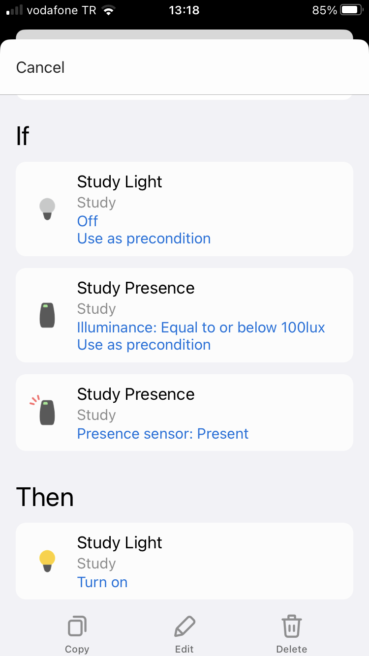

  3. I’m trying to figure out best routine to when the lights should switch off… Please have a look how can it be upgraded.

  3. set the Smart Presence settings ON
Thank you! I see you also set precondition that the lights are off, that’s a good idea!
