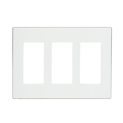

They make a variety of 3 gang plates. look on Amazon for the Amazing varieties. Most smart devices come with plates because they are dirt cheap; however, most (if not all) use standard plate cut-outs.
So the plates aren’t smart themselves…I think that confused me too.
Correct. The plates are just covers.
Do I have to buy certain covers if only 1 of the 3 contained within the same box is a dimmer switch?
You are going to buy covers with cutouts that match the switches in the box. For example, if all the switches are paddle switches, you want a cover with the three big cutouts. Can you post a picture of the switch bank(s) you are referring to?

If so, as others have said, if you remove the cover plate (which is literally just a piece of plastic, no electronics, no moving parts) you will see three separate switches underneath. You will replace as many of these as you want with individual smart switches. Most smart switches have tabs along the edge which you may have to break off to get them to fit: the instructions will be in the user manual that comes with the switch, so make sure you read that.

As far as a cover plate once you do have multiple switches installed, any Home Depot will have the cover plate or you can get them online. You just look for a “three gang cover plate.“ For most smart switches, you will want “Decora“ or “rocker style“ to get the right fit. :sunglasses: these come in different colors and finishes.

You will be able to find cover plates with all kinds of different cut out shapes to accommodate whatever shape switches you have underneath.
So example, here’s one for two toggle switches next to one rocker switch.
If Home Depot doesn’t have what you need, you’ll be able to find it online. And it all kind of decorator finishes, as well. :sunglasses:
And again, this is just the plastic piece that goes over the top to cover up the actual switches underneath. It doesn’t have any smarts in itself.
They also sell modular plates that you “assemble” yourself. While more expensive, you can get any combo or pattern you want.
http://www.homedepot.com/p/Leviton-Sectional-1-Gang-End-Decora-Nylon-Wall-Plate-White-905-PSE26-00W/100356951
That plate is part of a line that you can buy blank, Decora, toggle or outlet style plates for the end or middle. So, the possibilities are endless.
The big rectangle cutouts are commonly referred to as “decora” openings… just an FYI, smaller as JD explained are toggle.

Technically “decora” is a trademarked name which refers only to Leviton devices. They own the trademark. The generic name is “rocker.” But no question lots of people refer to that general shape as Decora. It’s like “Kleenex“ instead of “tissue.“
It’s just important to know that because of online searches. If you walk into Home Depot and ask for Decora cover plates, they’ll show you every brand. But online, you might get only Leviton results for your search.
agreed or jacuzzi instead of spa.
Or “paddle” in my part of the country. :sunglasses:
“Decorator” is another term used to describe them.
