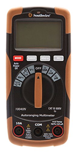

What are you using to measure it with?
Easiest way is with a clamp on current meter. Then do the voltage x current = wattage. Depend on the meter. It could be tricky to set the trigger point for the current rush.
https://images-na.ssl-images-amazon.com/images/I/41scM4RGOML.jpg
That’s all I have
An auto ranging multimeter
Oh my… You’re not find to get it with that. You’re talking about a surge that is going to last milliseconds. About the only way you’re going to get that is with an o-scope or a meter that had volts RMS.
If you had a high end fluke meter, you might be able to see the surge… Doubtful though.
Or, if you have one of those cheap 10 buck meters with the needle gauge…
All I have are volt meters and that’s the most advanced one I have.
