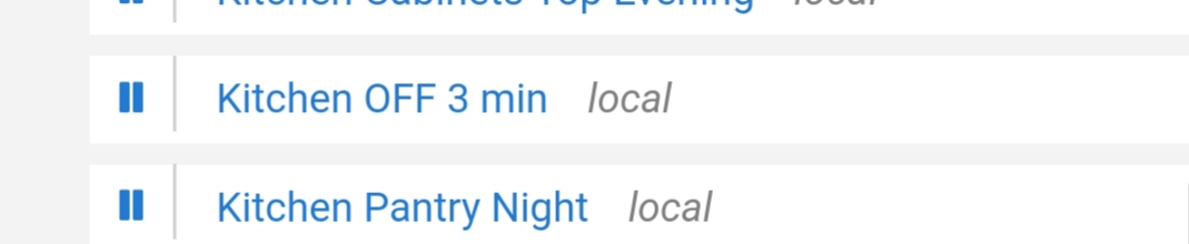

Disappointing "local" Smart Lighting instance ( turn off after motion stops)

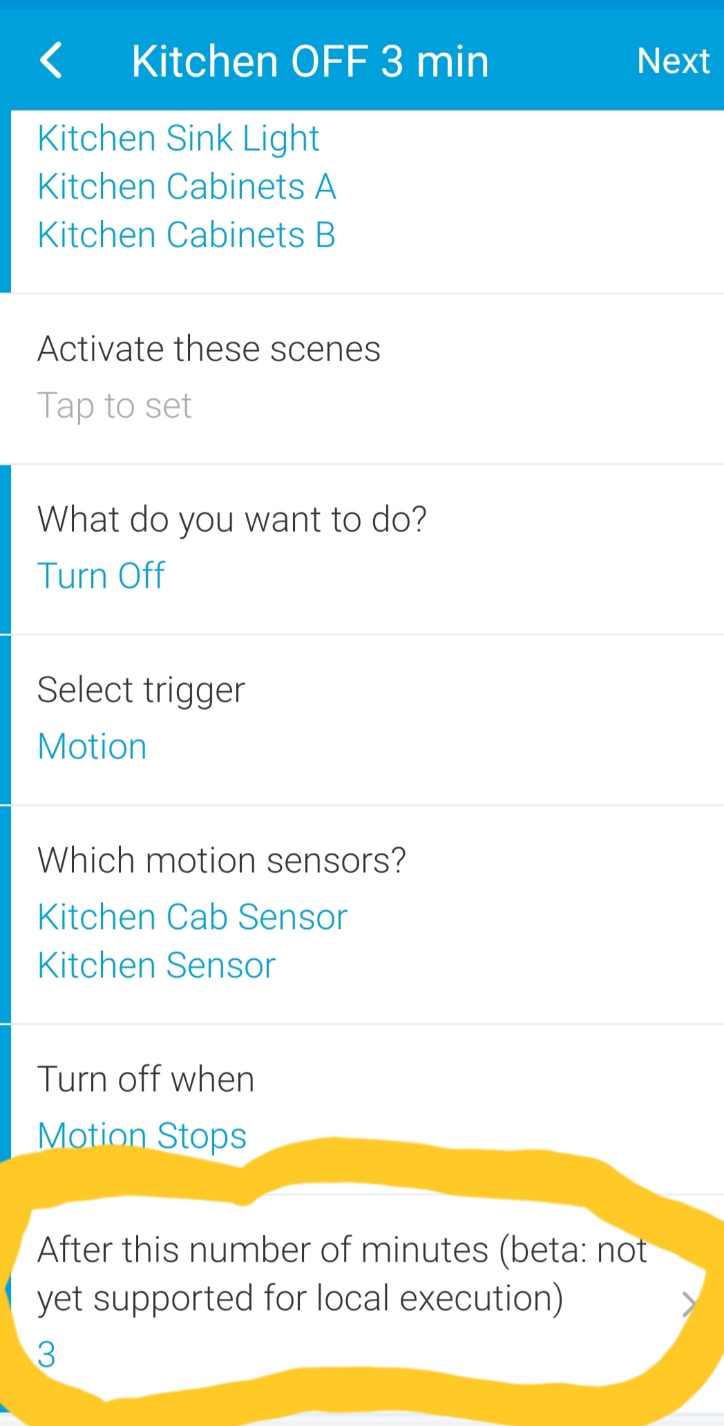

For the longest time I believed that “local” flag in ide next to a Smart Lighting instance meant that the app runs, well … local. Right? Basic stuff, turn light off 3 minutes after motion stops…
I was wrong! The warning in the Classic app is correct. No local processing…

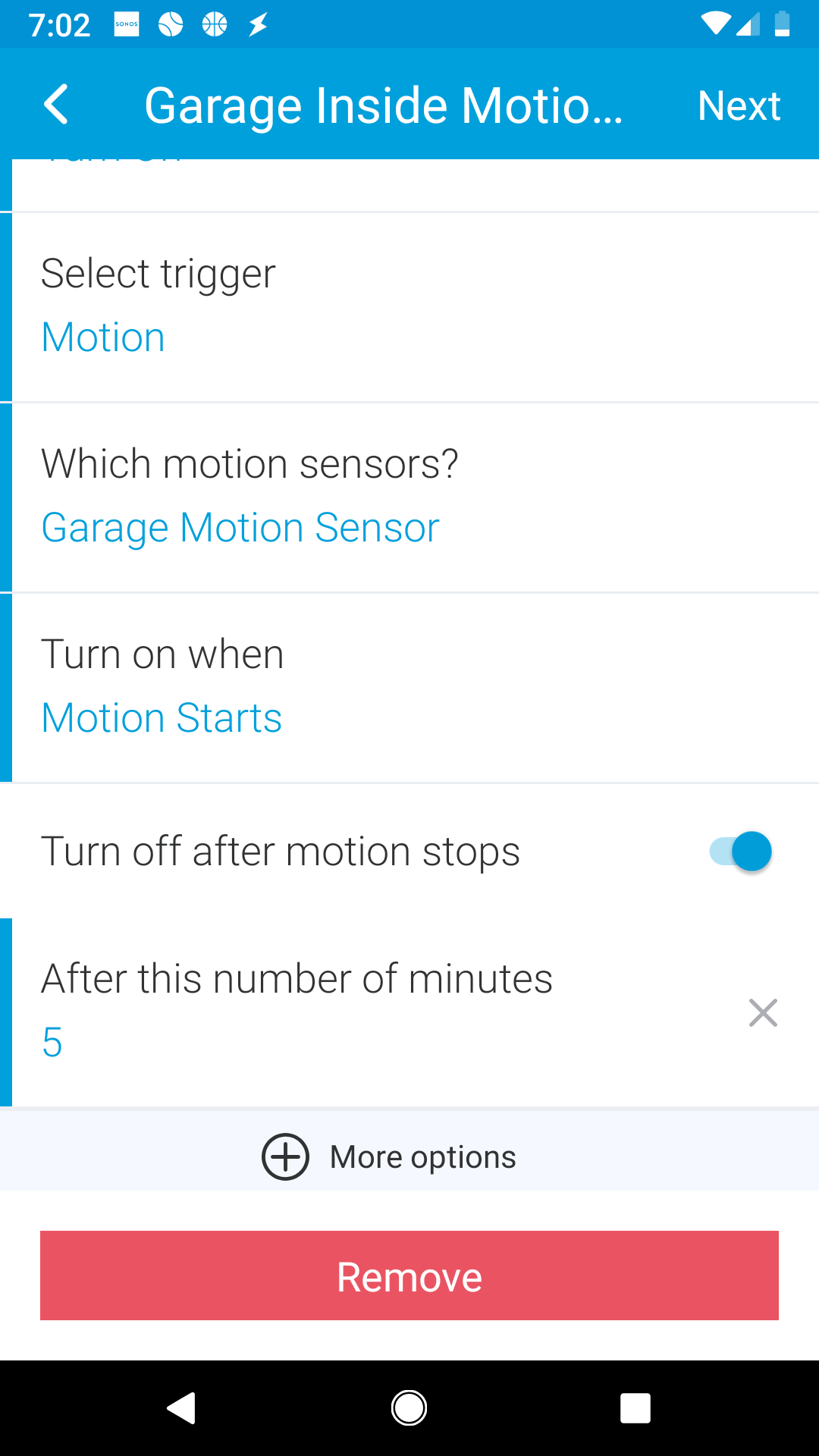

@HA_fanatic I finally got around to trying this. I have a Smart Lighting automation set up to turn on a light when motion is detected and turn off 5 minutes after motion stops. I unplugged the Ethernet cable and walked into the room. The light turned on as I expected and turned off 5 minutes later. So Smart Lightning with timers is fully local.
Have you tried setting one up only for motion inactive event? Like when motion stops, wait 5 min then turn off? That was the instance that failed on me during my outage (see picture in first post). However, I have since tried to replicate what happened during the outage and things worked local as expected. So not sure what happened during the outage and didn’t have the time to further investigate.
I have a Smart Lighting automation for my inside garage lights and a Samsung motion sensor that does exactly that. On with motion, off after 5 minutes inactivity.
I haven’t tested it when offline but I don’t see the warning you get in the app (either version).
Wondering if it’s specific to having multiple lights controlled. Or multiple motion sensors?
“On with motion and then off”, is confirmed to run local (if your devices are also local). Just the “when motion stops turn off in 5 min” is listed as “beta”/non local in the Classic app, however, I have tested previously and was actually running local despite the Classic app’s label. That appeared to have changed, or at least something happened during my internet outage and lights didn’t turn off as expected, which led to my conclusion that my instance is no longer local.
@HA_fanatic If I create a new automation with motion ‘stops’ as the trigger, I do see the warning in the new app. I’m not home to try it but I will as soon as I get a chance to see if it’s also working.
Like below? I get no warning about beta.
Turn off when… motion stops…
Edited: Ok, finally get it.
You’re not turning the light on with motion and including the turning off in the same automation.
You’re manually (?) turning on and automation is only for turning off.
