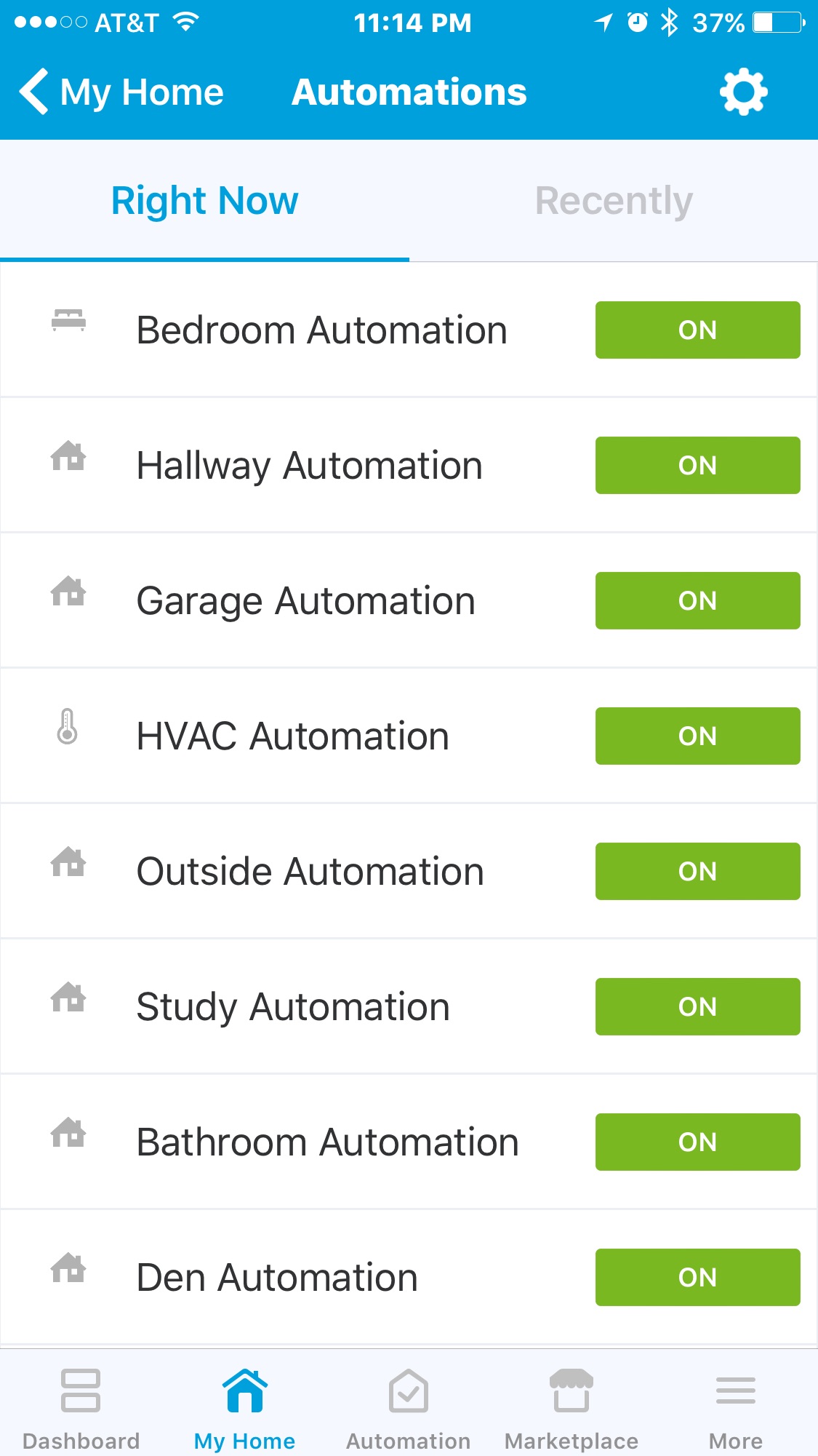

I have a virtual switch for every room in my home and even outside that simply says “Name of Room” Automation.
Den Automation, Kitchen Automation, Day Room Automation, etc…
This way, I can easily turn off automation to that room or thing by simply adding the rule that the switch has to be on in order for the rule to work. Even created a room that all of the automation kill switches are stored in for easy sorting…
I also have other rules that says if “Name of Room” Automation" stays off for “X” amount of time then Turn On…With these being voice accessible, I can’t find an easier way to do it…
