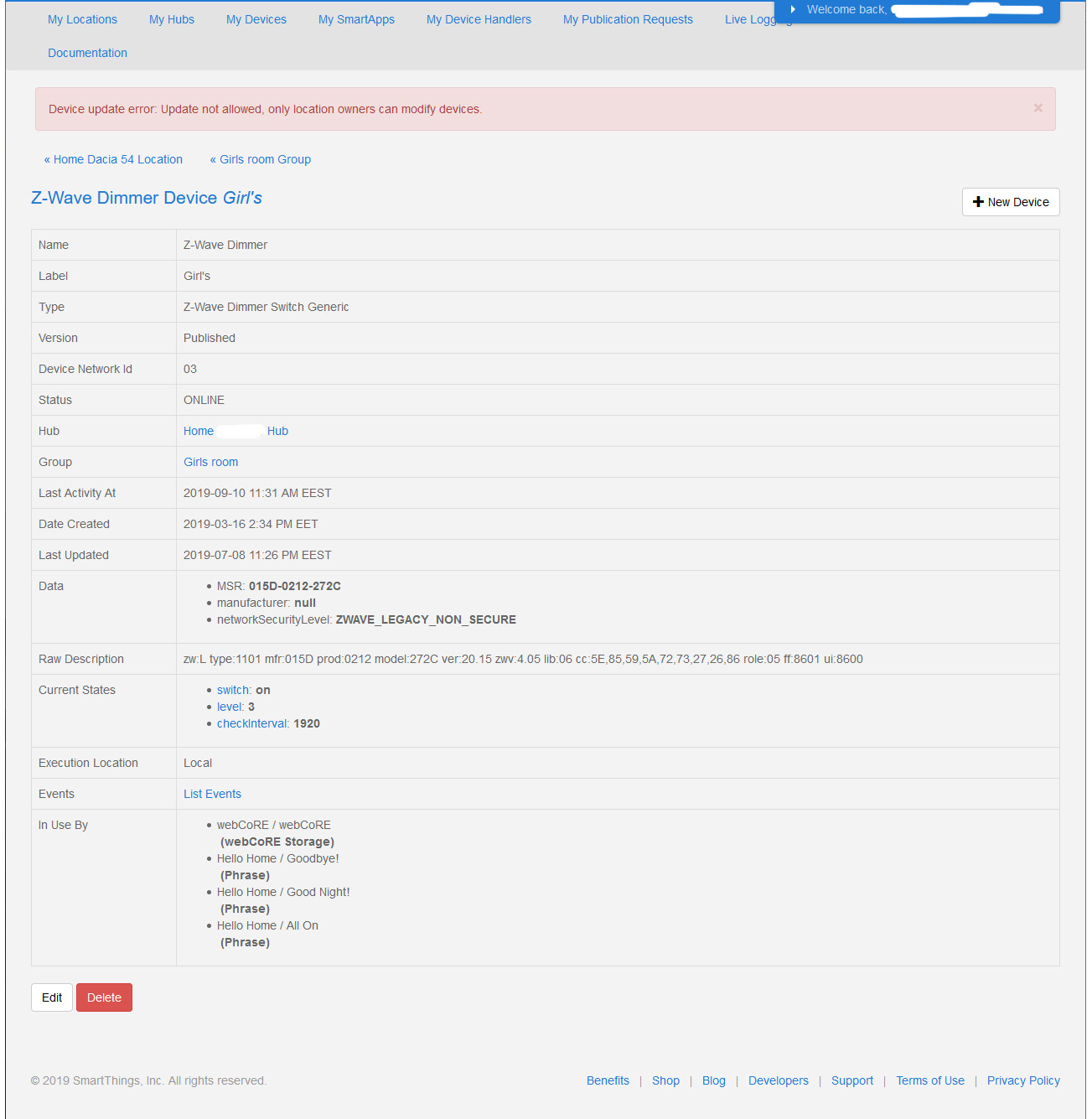

Hello,
SmartThings do not permit anymore modifications if you are not an Owner user of the gateway.
We have the same only Owners and Users but now, the Users do not have rights for modifications anymore. Which is a pain for implementers.
Bellow I tried just to rename a device and I receive this error.
There is a big need for Power Users.
Are any plans for implementing Power Users rights?

I just ran into the same issue after having to replace a door lock. Previously, shared users had the ability to make device changes but now it has been limited to the owner only. It is even written in the app, at least in the Classic one, that there are no difference in term of access between an owner and a shared user. I don’t see the reason behind implementing this change on the Smartthings end unless they would have given a way to set user permission levels.
In terms of my use case, I have setup a Smartthings hub to control the front door lock of a 2-family unit condo. The owner account is linked to the condo email address, which is basically a distribution list, and shares access to my own account on which I do all the administration. The reason I am not using the owner account is: (1) I don’t want to spook my neighbor each time I log in the account as an email notification is generated; (2) I prefer having all the customized smart apps and device handlers under my account as I have another Smartthings hub for my personal usage that share some of the same code.
Has anyone found a way around this restriction? Also, out of curiosity, what happens if I set a DTH on the owner account and link the device to it and then load the same DTH on my account, make changes and publish the updates, will it update the original DTH? This is exactly why I didn’t want to start juggling between accounts in the first place to make config changes.
I have the same issue getting same error message : Device update error: Update not allowed, only location owners can modify device types.
But the issue is that I am location Owner and I try to add my own custom device, but the system act like I am not location owner?
Do any body know whats going wrong?
