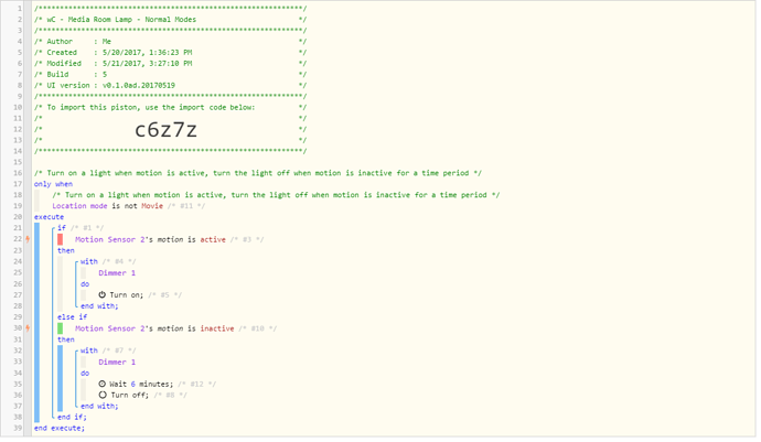

I copied this from the example piston in the wiki (I added a mode restriction).
It doesn’t seem to work as I expected - once the motion sensor is inactive and the countdown timer starts, it doesn’t “reset” if the motion sensor goes active again. The light will always turn off at the end of the timer. Any ideas?
@sockmonkey, try removing the cancel on piston change event.
@KellyDarren, I changed it to the default (Cancel on condition state change). Unfortunately it didn’t change the behavior. The light turned off after the timer despite the sensor going back to active.

@KellyDarren, thanks for the help here. I’m new to this (this is my first piston) so I really don’t understand the additional “complexities” that were originally in the piston or why they were needed. I simplified the piston, below, and it seems to work exactly as desired so far.
