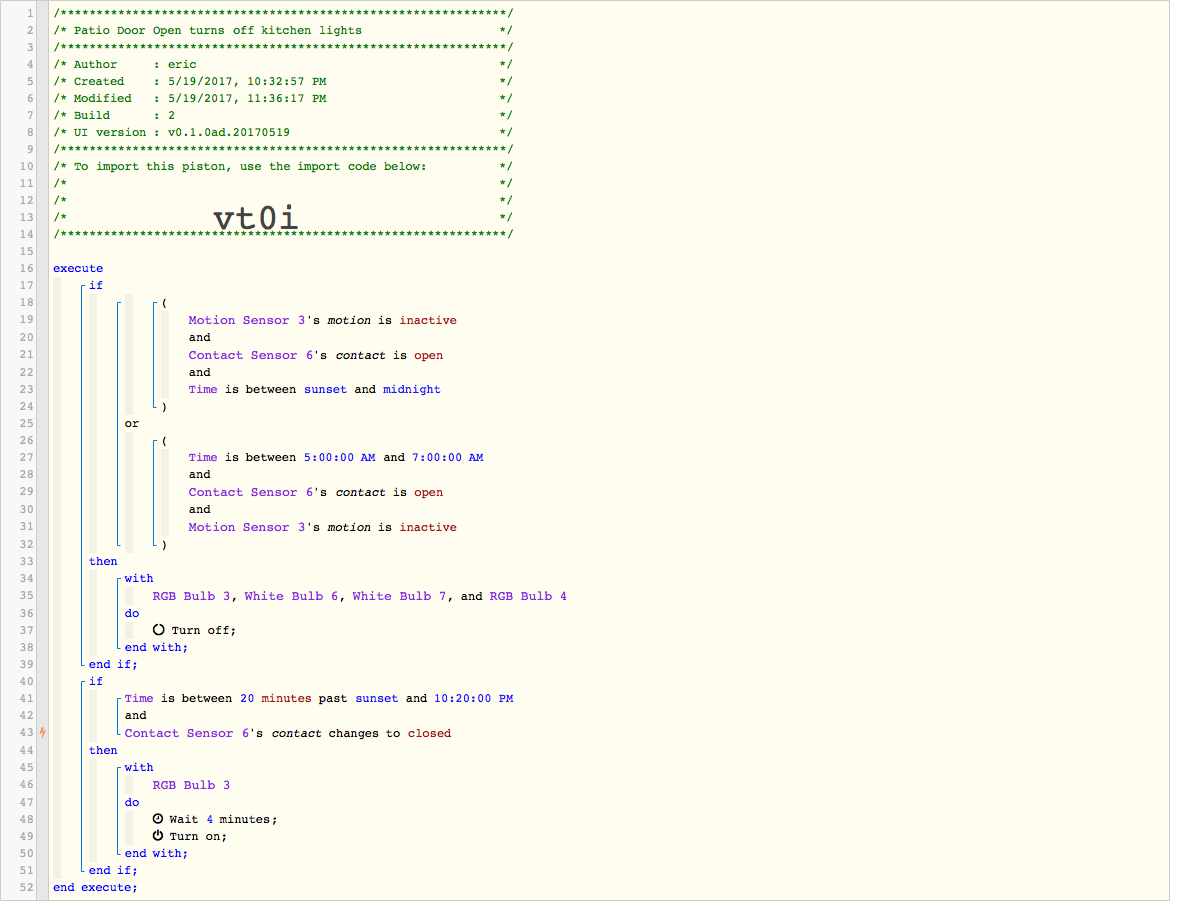

what’s the equivalent of a OR-IF piston. at line 39 in this piston is where it was an OR-IF piston in regular core.
is there a special way to do it?
Drag it out of the THEN section for your first IF. Unless you only want it to run when the conditions up top are met.
Correct. Only other thing I might suggest is adding a subscription to at least one device each in the first two groups
thanks for that. the $previousDeviceState did show up in the drop down list, hence trying to use it.
But the previousAge function did the job in the end with a bit of trial & error e.g.
previousAge([Central Heating Control : thermostatMode]) /1000 /60
can you please explain what adding a subscription does? how would it be of benefit? thanks!!
EDIT: I just went into the piston and selected one of the conditions. Actually they all say “automatic” for event subscription. I read the wiki but I’m still unclear of what this feature does.
Thank you.
‘subscription’ refers to webCoRE ‘listening’ for events coming from individual devices, which could trigger the piston to fire. Right now, the only event that webCoRE is litening for, is Contact Sensor 6. I suggest changing the condition for that sensor to ‘is’ instead of ‘changes to’. Or change the subscription like @c1arkbar suggested, to ‘always subscribe’.
So like @SBDOBRESCU mentioned it tells webcore what events you are listening for. If you do not have any subscriptions then your piston will never fire unless another piston executes it. (How a follow up piston worked in CoRE).
So in the top if you need to tell webcore what you want it to listen for. Otherwise it won’t execute based on anything up there. Conditions automatically subscribe until a trigger is introduced. Then conditions become more like restrictions. Since you have a trigger at the bottom you need to force a subscription (always subscribe) on one of the conditions in each group up top.

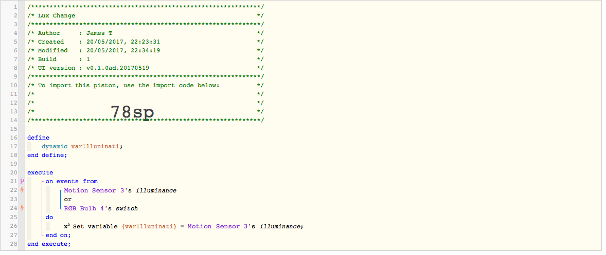

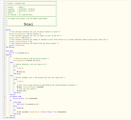

@anon36505037 Is this piston working for you to track lux changes? I have tried implementing this in a piston and even by itself and the lux isn’t being stored in the variable:
This is the piston I’m trying to add the code to:

My old Lux change was the following:
This worked all the time but I thought I would go with what you mentioned about bringing the variables inside the controlling piston.
Lol - I use lux changes throughout the house for in the day time - here in the UK the lux changes so frequently, especially when its raining out

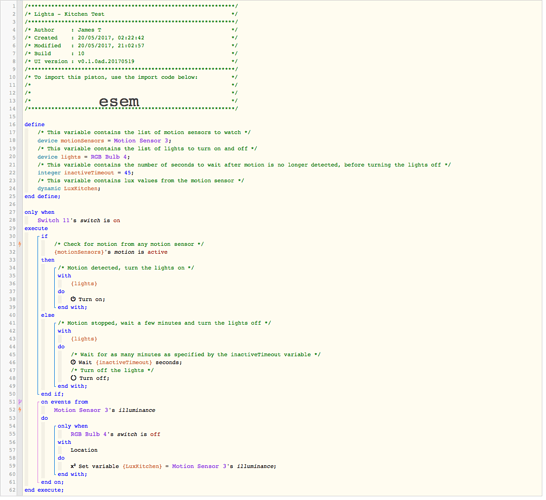

hmmm - when the conditions are set in their own piston (basically importing noz3), lux variable changes. However when I add the individual items to the other full piston, it doest report the new lux settings:

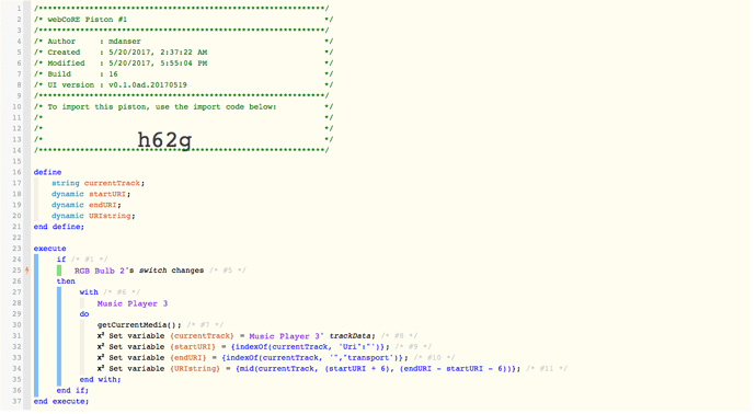

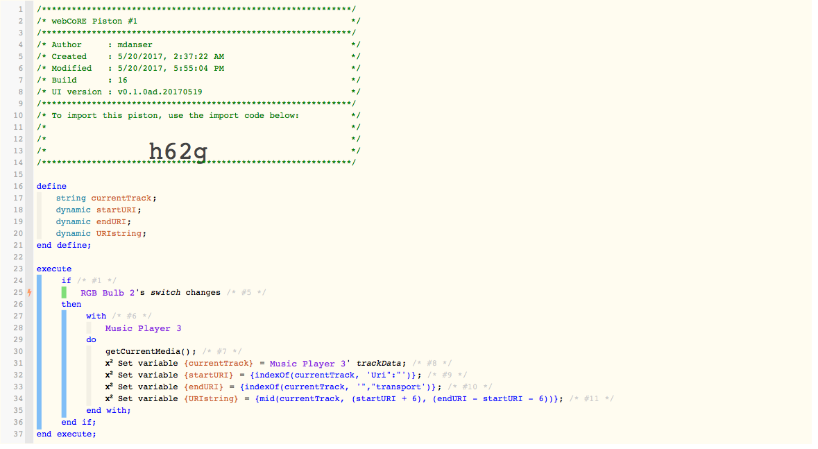

I am trying to pull the URI of the currently playing track on a sonos speaker and then use that elsewhere. I am able to pull all of the track data and store that in a variable, but it is more text than just the URI itself. Is there a way to get a substring of the variable text I stored?
It ends up setting currentTrack to “{“station”:“RINCON_5CAAFDA596E801400”,“name”:null,“artist”:null,“album”:null,“trackNumber”:“1”,“status”:“playing”,“level”:”",“uri”:“x-sonos-htastream:RINCON_5CAAFDA596E801400:spdif”,“trackUri”:“x-sonos-htastream:RINCON_5CAAFDA596E801400:spdif”,“transportUri”:“x-sonos-htastream:RINCON_5CAAFDA596E801400:spdif”,“enqueuedUri”:"",“metaData”:“RINCON_5CAAFDA596E801400<\u002fdc:title>object.item.audioItem<\u002fupnp:class>x-sonos-htastream:RINCON_5CAAFDA596E801400:spdif<\u002fres><\u002fitem><\u002fDIDL-Lite>”,“trackMetaData”:“x-sonos-htastream:RINCON_5CAAFDA596E801400:spdif<\u002fres><\u002fr:audioInputIcon>21<\u002fr:streamInfo> <\u002fdc:title>object.item<\u002fupnp:class><\u002fitem><\u002fDIDL-Lite>”}"
@anon36505037 - thank you Robin. That seems to work. Setting the wait ‘Else…With’ on the wait to async does seem to be populating the the variable now. Lol its dark here so Im testing but holding my phone torch to the sensor (making sure to not trigger the motion) and the value is now changing.

@Michael_D I have the same issue. I can pull out the full data string to a variable but can’t find out a way to use the URI. CoRE handled this pretty well
