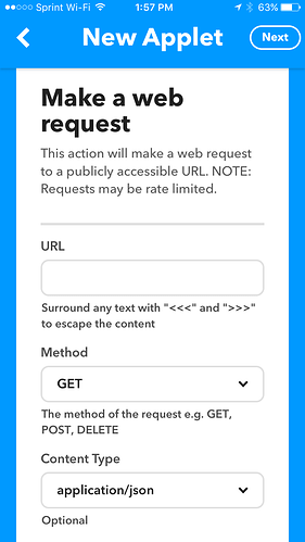

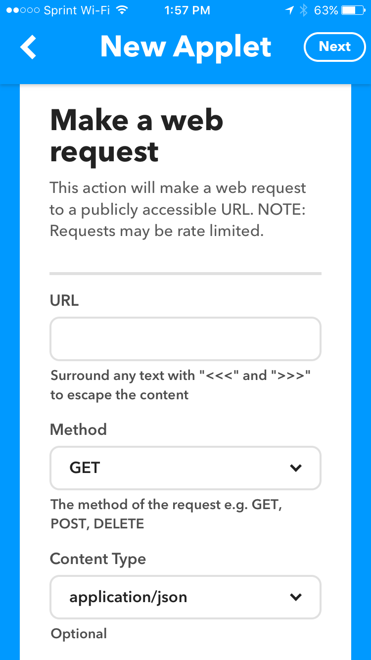

I would like to use CoRE to control my automower but I don’t know enough to dive in yet. I know that I can send GET requests to the server to control the mower but the server requires authentication and I don’t know how to incorporate the username and password. I’m not a programmer so I am looking for help in simple terms. Thanks much!
Don’t know if I’m much help but doesn’t ifttt support sending get request using webhooks, I’m guessing automation can be achieved that way by creating a virtual switch in smart things, then linking that switch to ifttt to make the get request. And automating what ever you want with conditions for the virtual switch in webcore.
As for as the log in goes I’m not sure for your particular mower but some of the things I’m used to dealing with when making web request have the login info built into the url or body

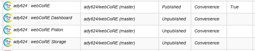

Don’t know what your are talking about :rofl: I only publish the parent app and it works fine :wink:
Am I missing something?
