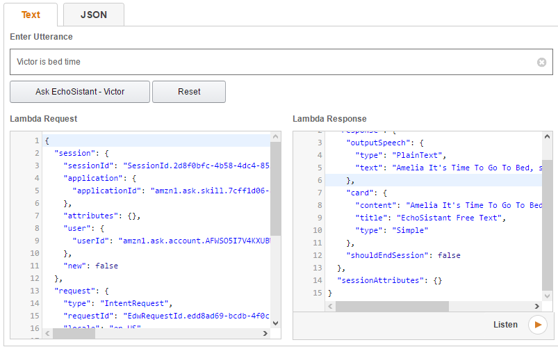

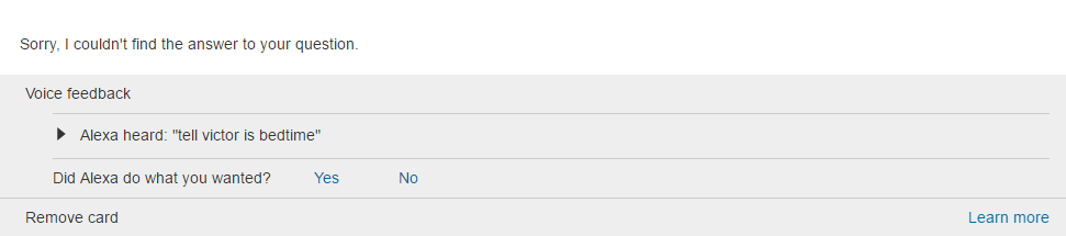

I don’t have external speakers. I’m using LANdroid Announcer. I have just created a test profile inspired by “Baby is going to bed” example in the wiki. My profile is called Amelia. When I type “Amelia it’s bed time” in AWS Test I’m getting the message repeated on my phone speaker and a lamp turns off. When I say"Alexa, tell Amelia it’s bed time", she replies “I’m not quite sure how to help you with that”
I’m sorry you’re having trouble. Will you please open the live logs and try it again. Post a SCREENSHOT of the “Amelia” profile after trying to run it again.
also, look in your Alexa mobile app and make sure that Alexa is hearing you correctly.
I have changed the profile name from Amelia to Victor as Alexa had some troubles hearing that.
06:56:55: debug As LAN: [index:17, mac:D022BEB44F44, ip:0A001109, port:040B, requestId:03a957e6-8751-484e-a82a-59718a95b180]
06:56:55: debug Parsing ‘index:17, mac:D022BEB44F44, ip:0A001109, port:040B, requestId:03a957e6-8751-484e-a82a-59718a95b180’
06:56:55: debug running actions, sending result to Parent = Amelia It’s Time To Go To Bed

Thanks!
it’s looking it’s working, unless I’m missing something… is that right?
Unfortunately it doesn’t work. Alexa doesn’t have a clue what “Victor” or “Home” is. Thanks.
In your AWS main skill and profiles skills, did you choose the UK language.
It looks like you might have the US language selected
Bingo. Working now. Another stupid mistake from me. The Main Intent language was set to English US.
