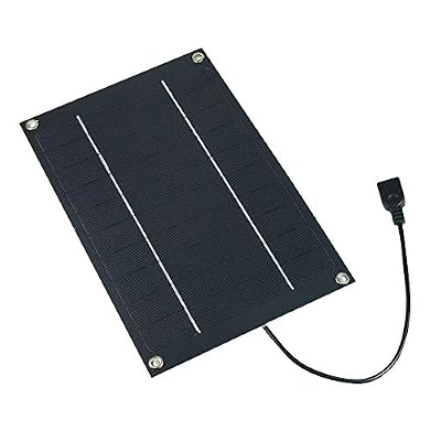

Update to my Solar Powered Blink Project.
Just purchased 2 of these Solar Panels to run my 2 Blink cameras already installed outside my house. Wish me luck that the panels are of desent quality. Will post an update when they are installed.
