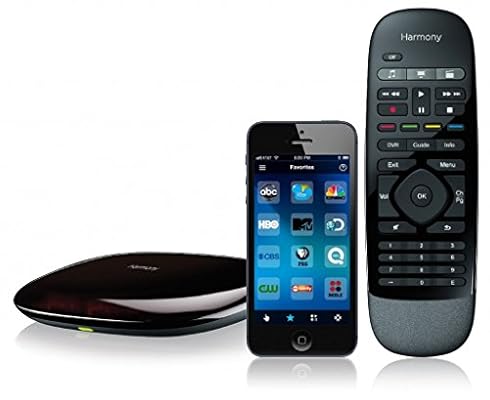

You may not be interested in a “packaged” approach, but using the Harmony hub/remote combo will allow you voice and webCore control over your TV activities, including starting your Roku activity (turning all devices on that need to be on, setting inputs, etc.) pausing and playing, volume, etc. It also provides control over SmartThings devices (e.g., you could create an activity in Harmony that starts up your Roku activity and also turns certain lights on or off, and (if you have a TTS speaker) says “I"m watching Roku - silence in the house!”
